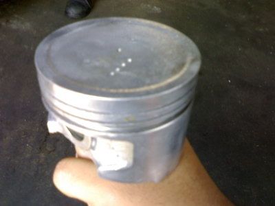

totally..std..12v piston 75mm..u can see the piston had been mark..its a no 4...which i dun like it to be done like that..even using the same way to mark all the valves...no no no..!!!!!

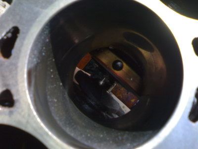

stock block..no rebore
just look at the wall....bore till 85.5m???....

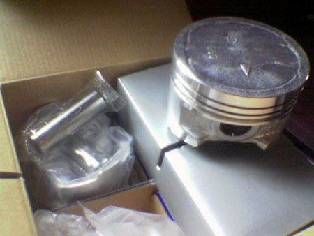

non-std +0.5mm piston
