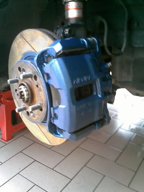

Hi guys.
Thought i would share with you guys my mini project.

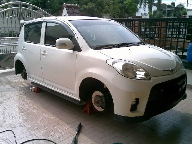

Car was jack up and all 4 wheels was removed.
Calipers was then wash with high pressure washer and scrub it till i feel it's clean.
Then i painted it with Hammerit - Hammer Blue colour to the calipers.
This is the finish product.
More info on the paint can be found by http://www.hammerite.com/global/products/index.html
I guess spraying will have a better finishing..smoother..but from what i brushed , the finishing is considered smooth to me..Erm , the paint that i use to paint my calipers are ( Hammerite , Red Engine Lacquer , Protective Coating For Use On Liquid Cooled Engines , Temperature Resistant to 150 degree celcius and etc..It cost me RM27..The smallest tin I could get..
