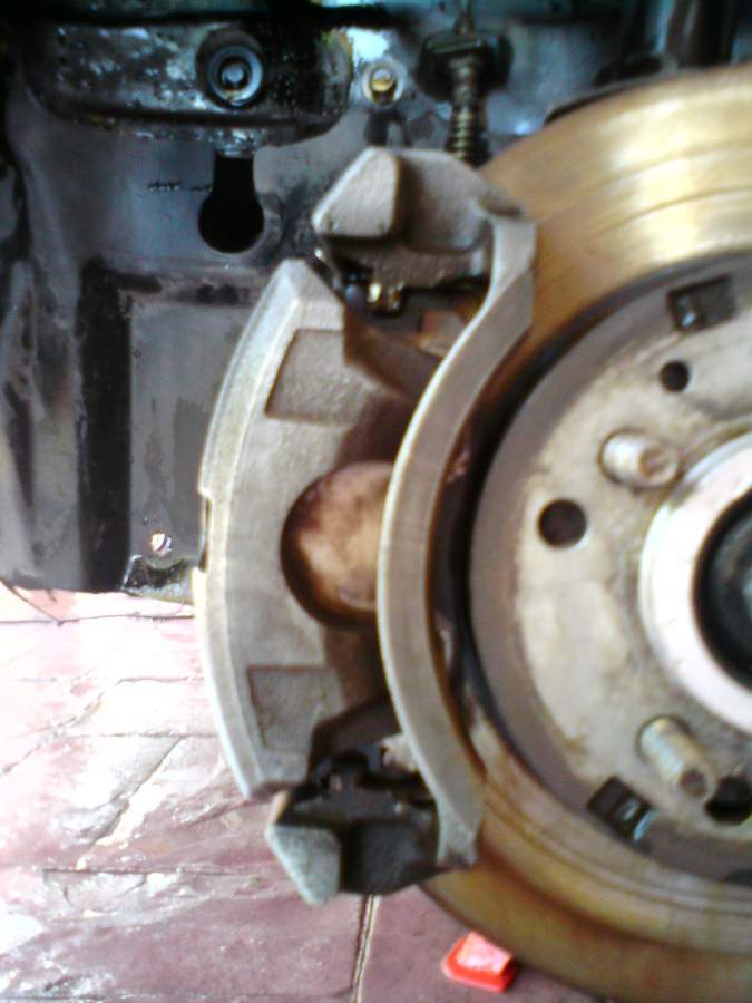

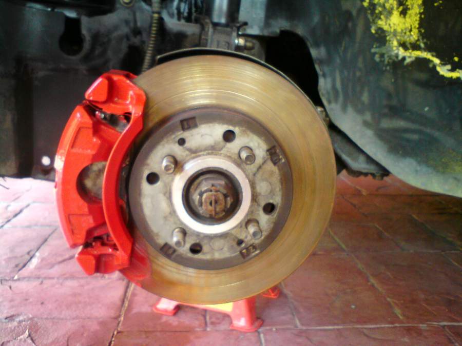

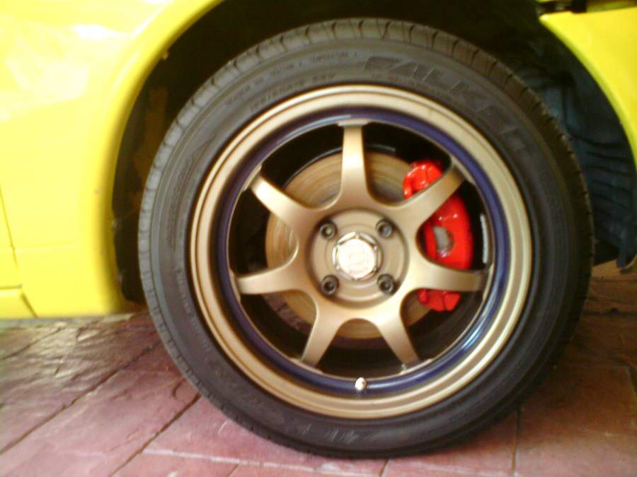

quite simple actually
1. remove rims
2. clean up all the hardened grease or watever u can clean as u wan the calipers as clean as possible. ( took me a while wit this as i clean everything in that area )
3. spray on wit ur choice or colour n layers depends on wat brand u using - ( im using Bosny )
4. wait till its dry or u happy wit the colour then fix in ur rims n tighten it all up
5. yam cha n stare at ur calipers haha
