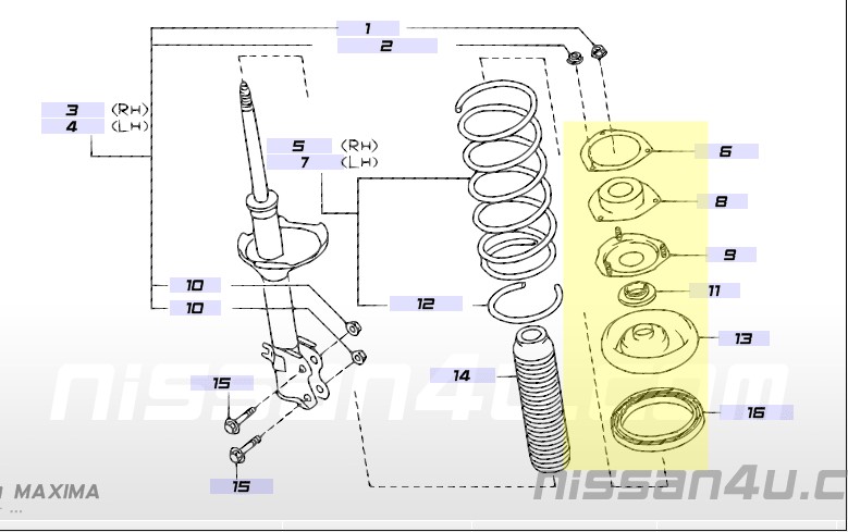

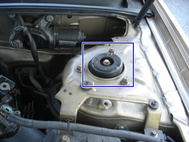

I bring my A33 to TKA in nibong tebal last saturday. The person in charge Dennis told me that the "bump stop" on top of the absorber wear already. And the absorber no problem. Just replace the "bump stop". This wear causes a clog clog noise when go over bumps. All nissan has the same problem woh... So he ask me to go get the parts for him to replace.
I search bump stop from unker google and it turns out another thing. So I am not sure if i were to mail order from PH auto, they will send me the correct items.
attachment.php
After searching for the parts assembly, found that there are so many parts sandwich in between. And NONE of them name BUMP STOP.
attachment.php
So my questions are:
1) which parts should i get to get it replace from the sets of parts listed?
2) or its a common practice that spare parts shop will sell you the whole set in 1 go? (in yellow highlight area)
3) If get it replace, it should be replace both side or 1 side? Because right now only the left side noisy.

absorber top mount loh. it come complete. Also ask for the rubber seal.

I've been checking the absorber noise "clog clog" for so long time, even change to a new set the noise still there but it's lesser only, hope changing the so call bump stop will help. (also need to check where/wich part is call bump stop)
Top mount, oh i c.
attachment.php
attachment.php
ref: http://nissan4u.com/parts/maxima/er_ca33/2003_6/type_2/axle_suspension_and_steering/front_axle_and_front_suspension/illustration_2/
attachment.php
"mounting insulator and rubber parts"?
i doubt any shop selling that part only unless it is local made adjustable type
