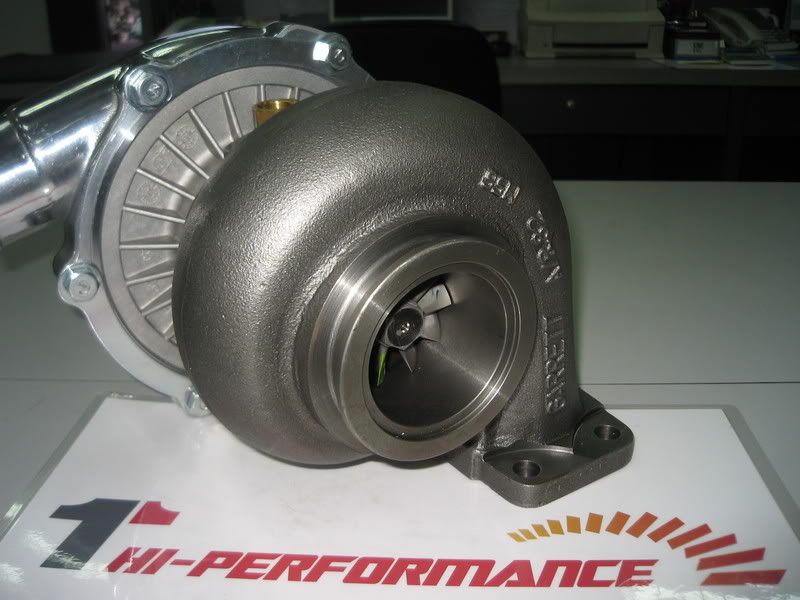

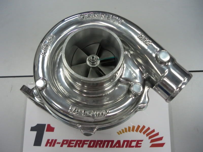

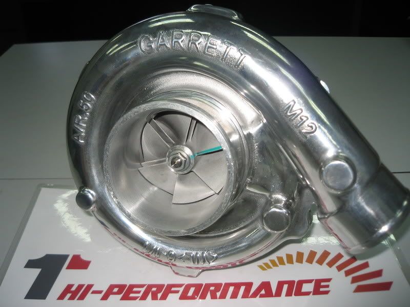

why buy used...we've got new units on offer now..
T3/T4...Genuine GARRETT.
RM 1,888 only

SDF: is this ball bearing turbo?? can squeeze out how many ponys??
i was just wondering...i Have a K27 turbo,i think the shaft bit bend already,how much does it cost to get it fixed ya?
guys this ain't ball bearing..itz made for buget conscious customers..
it'll be an easy 350 ponies for 2litre guys.. ;)
