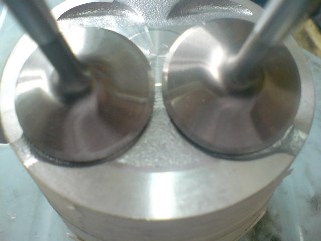

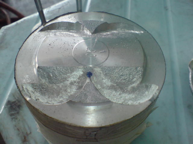

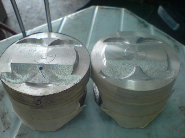

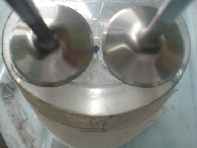

doing his own calculation on the piston valve pocket. calculation or just estimation..?
haha. risk on your own dude...
here goes my 700 bucks psiton and 1000 bucks valves..

Heh.. that one is enlarging valve pocket.. to measure valve piston clearance, is a much more elaborate procedure. Need to take out head more than once, and need to lock vtec cam lobe to measure / clay because each cam will give different clearance measurements after degree-in the cams. :P
yayaya..
load of thing need to be done....
install head, plasticine, lock cam lobe, TDC, open head, check plasticine for valve to piston clearnce.
repeat all of above for few times..
damd long process,
that y i bought a new cylinder head and a used cam for him to measure the clearance,

hehe.. my pistons seem much dome than u.....
