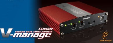

1. Mircotech
2. Haltech
3. E-manage
4. V-manage
thanks to all taiko out there....
im stil learning....
ok la... if anyone can link me to previous topic... that would b very helpful...
tq....
The first two mentioned are standalone ecus whilst the last two are piggyback ecus. In simple terms, standalone ecus completely replace the factory ecu and is able to control most, if not all aspects of the engine's operations but usually limited to the performance aspect (full control of both fuel injection and ignition timing and a host of other features e.g. boost control, valve timing control, launch control, nitrous control, etc etc). As for piggybacks, they ride on the factory ecu and are usually able to control fuel injection (via altering the air flow signal to the ecu) and ignition timing but are limited to the factory programmed parameters. Good for basic mods to the engine but for all-out performance, you will need the standalone ecus, which naturally are more expensive.
