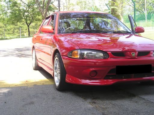

No mods at all only a minor ICE upgrade and rims... thats all ... engine all dead stock... here is my car pic :
Everything stock la... normal car...
same like u ... stock engine.. jus simple player
nice bling bling rims ya got there... 16" ??
