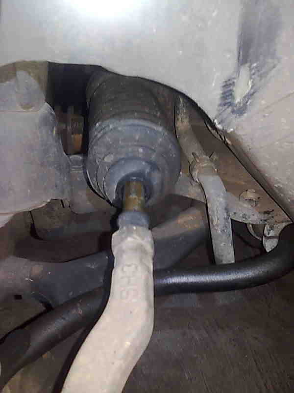

just noticed my PS fluid are low and found out that my tie rod have leaks. what are possible solution?
p/s: i've replaced whole steering rack less than 2y ago

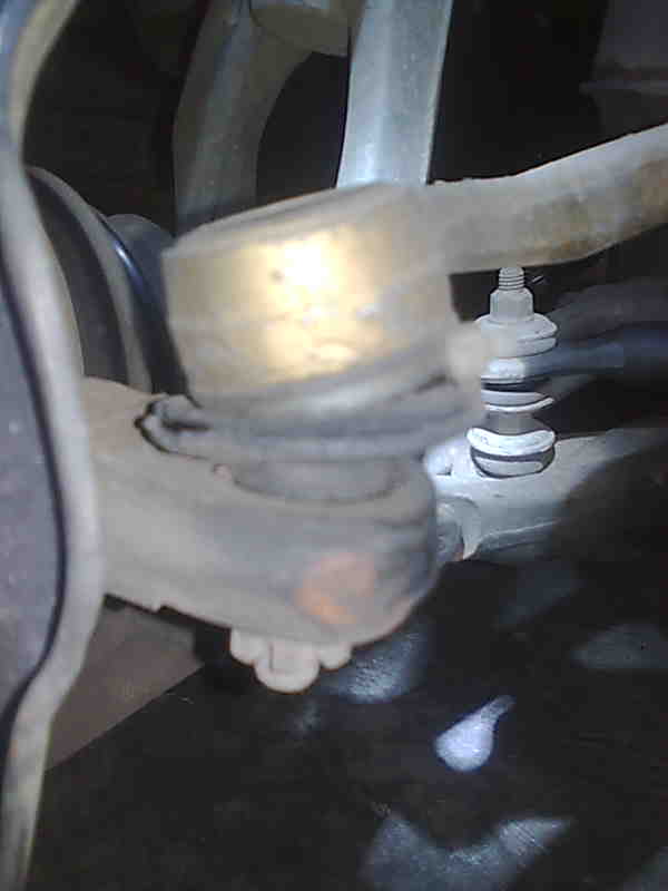

another question from pic below... do i need to replace bush? (outer tie rod)

You said your PS level was low. You might want to open up the boot to see if the PS rack is leaking or not. Looks like in the picture it might be leaking. There is grease on the inner side of the tie rod but it won't usually wet the rod like your picture. The outer tie rod looks like it needs to be changed.
