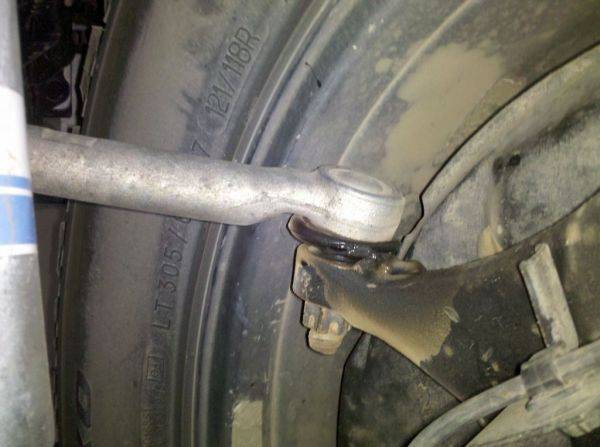

Previously my old worn out knuckle (bearings) the tie rod end sits like this...the screw end up upright...
Sample picture
http://wiki.r31skylineclub.com/images/thumb/5/5f/S13_hyundai_toyota2.jpg/600px-S13_hyundai_toyota2.jpg
then I've changed to another model knuckle that have a bigger disk and caliper...but now the tie rod end , ends up the other way around, the screw end bottoms down...

After changed it , I'm having some issues :
1) The steering feels a bit awkward ...the steering wheels when cruising 120km/h, it seems to follow the road surface...
2) when turning left, when the the suspensions, re-bounce back down...the steering wheel tend to turn slightly to the right...

Bump steer issue...hmmmm...
I realize the tie rod wasn't linear enough...it was raise a bit...
now tie rod is in down right position...adding screw will raise it more...
else i need to raise the rack...wallauweehhhh...carzy aaa... :P
arghhhh...need to change to old knuckle aaa ? :banghead: :banghead:

last night re-check it...the tie rod can be flip upside down...need to sent to engineering...make the cone shape slot upside down...
hahahaha...issue settled...
make the a bigger hole...pump the new slot it, so the flipped tie rod end fit nicely (ketat maaa) ...nice !!!
the tie rod are linear / straight as it supposed too...thank god...

The cone is machined to the knuckle steering arm so that the tie rod end will center itself on the steering arm hole.
