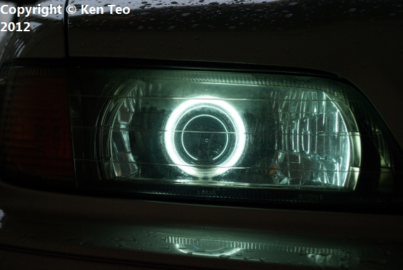

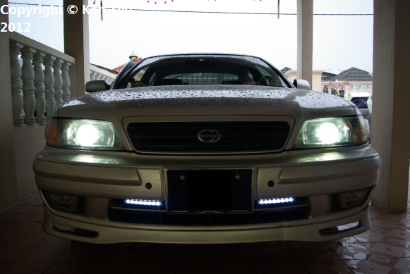

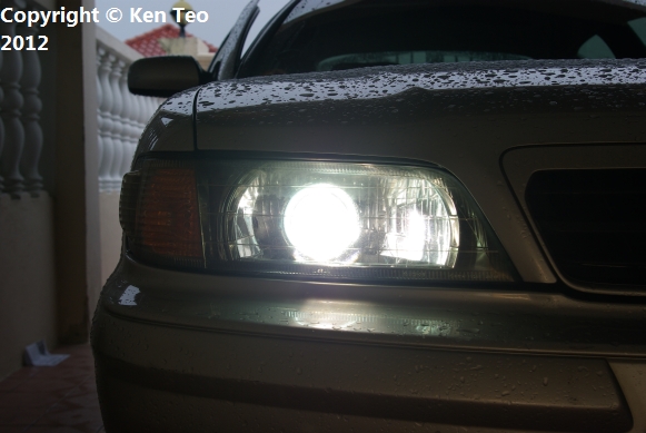

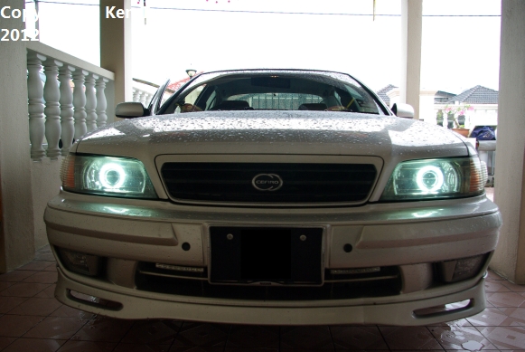

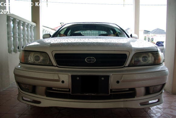

i've retrofitted my H4 to a bi-xenon projector H3C 5000K 40W HID with proper glare cutoff. Night driving is a pleasure now as it can project close to 40m on my headlamp. will update with pics when i'm free this weekend

result of HID projector lens modification
HID: 5000K 40W H3C
Distance: approx. 7 parking bays (engine to bonet type), roughly 35 to 40m, 80+m on high beam
FOV: approx 120 degrees to 140 (with HID fog light on, around 160 degree)

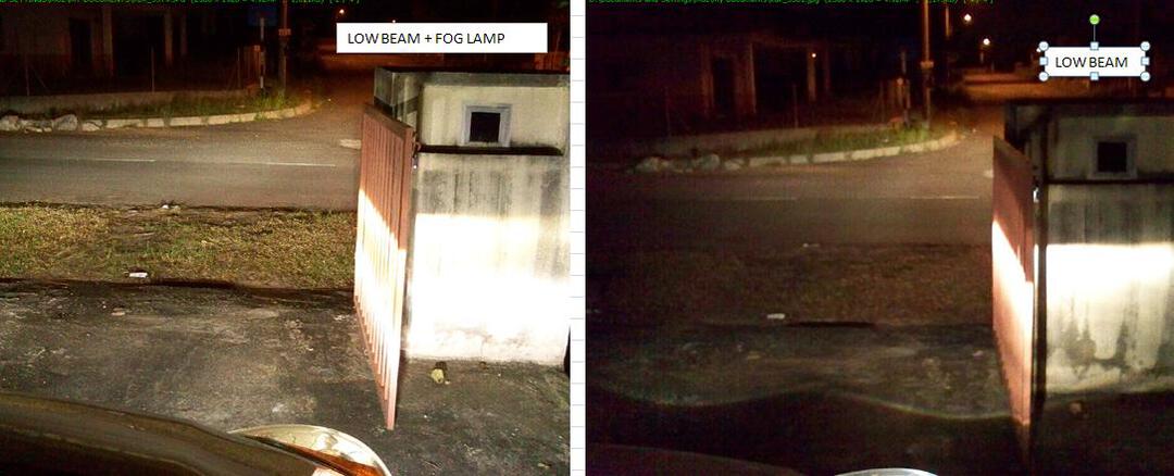

I put HID on my Fog Lamp only..quite bright and save if happen to meet a JPJ roadblock..can turn it off..
attachment.php
Nice shot bro... And looks like you got very nice cutoff. And I think your colour for foglamps is more practical too. Unlike people who only want style and not think about practicality, those who use 6000k or 8000k for foglamps.
