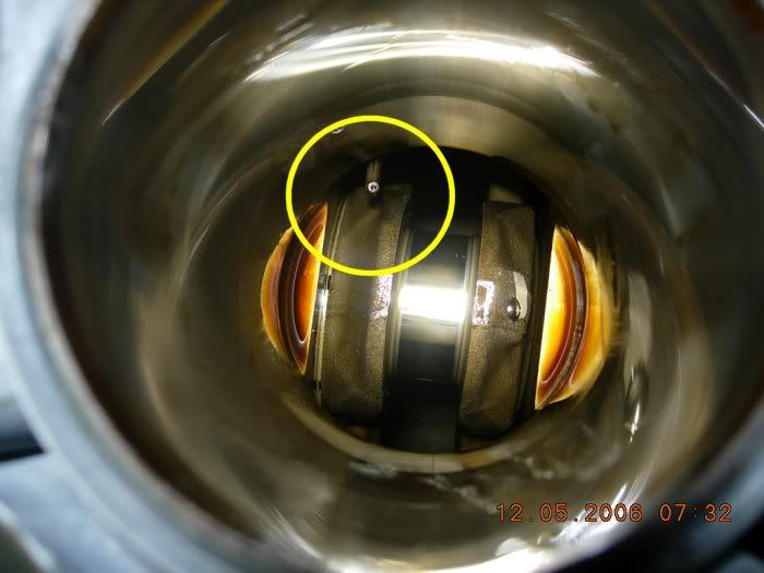

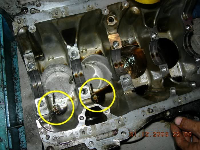

Piston sprayers ? What are those ? I thought the block only contains crank shaft,con rod,piston+piston rings ?Hehe...
if u dismantle ur "vitek" block u will find there is 1 "steel" hose pointing up at the bottom of ur block at every cylinder.heheheh pandai juga ini org jepun can built in those thing i go and kasi patah that hose just to see where the oil come from.although logically i know where it came from

As for piston sprayers, they spray oil into the cyclinder walls to cool off the wall and piston, which is one of the key design features that allows honda engines to rev reliably at high rpms.

this one is piston sprayer that u mean rite?
