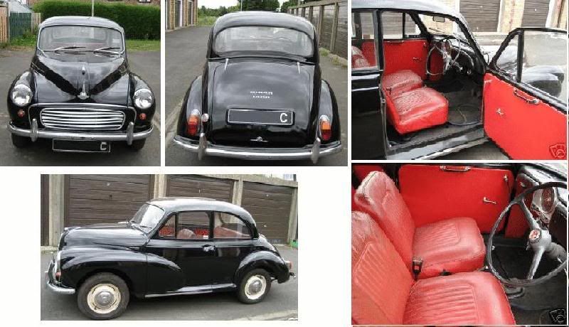

My point is just to get the car moving with engine which is OK interms of durability and fuel consumption. I dont want to waste so much money on this project. As long the car moving and I can go 120kmh-140kmh at the highway... Im happy already. There is no value to the classic car if its heavily mod... like one Volvo122 classic but with sport rims, bucket seat and all sorts of meter at the dash board... definitely I wont buy the car.If I want much better preformance then my v6tt ..... I think I should convert my Toyota Corona to RB20 instead but no point if the car just sit at the car porch. Even my v6tt is hardly move.

I think its the same weight as those daihatsu charade.... it looks big but light otherwise how the original 1.0cc engine can pull the car. The car still at the workshop since the mechanic still cant find a good Suzuki engine yet. There are good one at chop shop but too pricy coz its not a half cut but a whole car !
My mechanic call me and ask me if I want to use daihatsu L500 N/A on the car coz he cannot find any Suzuki Jimny halfcut which in good condition. I ask Turbo but he said the engine bay will be extreamly tight ( Morris Minor engine bay is small ) n he has to move the intercooler from top to front which may coz some other problem.
I'm not really sure how the performance of 700cc engine fitted into 1.0L car. He also have to fit rwd gear box which is from Jeep or Datsun.... goodby LSD gearbox. How he going to do that .... I dont know... never come to my knowledge a Daihatsu MIRA L500 with rwd gearbox. I also ask him to upgrade the dashboard meter which another problem.... the dashboard is made from metal... : )... not like modern car... its like VWagen dashboard. The original only have speed meter and fuel meter... so how about water temp, rpm , battery meter and warning signal ?
I just ask him do what ever he can do but not a single cut on the engine bay and dashboard.... he ask for RM5k for the engine and modification. Hard for me to say NO since many workshop rejected when I say Morris Minor. I will inform the end result when all are done. I hope he know what he's doing otherwise all my money go to drain.
My car look something like this
a truly classic & oldskul car u got there bro!hehe.if we live in US for sure will send those kind of car for heart transplant.1st on my list is V8 hemi 350 hehe :_: or Roush V8.but in malaysia?ishhh money do the talk.haha.Hot Rod rulez!!

the engine bay for this car is at back right?so why dont u consider the VW boxer engine?or imprezza boxer for more power!haha:shades_smile:
classic man!.......
