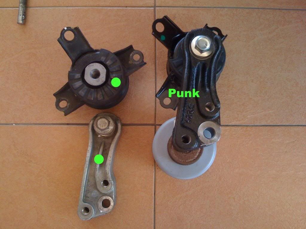

  • Comparison of old mounting and new mounting
  • Only Driver side engine spoil
Passenger side small crack only
Bottom engine still ok (diy this part can die if car fall down :biggrin: )

Great job dude. How long does this diy take u to complete it? How to determine it is the time we need to change the mount?
7Hours.:creep: ( very tough to diy )
Actually, i seldom drive this car.
I only notice the car have engine vibrating issue when idling.
Dashboard also got sound.
After change the mount, no more shaky and feels smooth.
The owner ( my sis) said car feels lighter.
Maybe the engine drop one side affected the car performance.
I thought bottom engine mounting spoil also because everytime engage gear will jerk. ( i was wrong )
