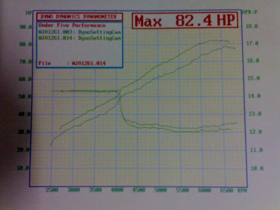

I've done dyno runs when i sent the car for camshaft tuning and found that it's running rich from 1000x rpm to 3000x rpm. Could there be any problems with my fuel regulator? Apart from the mods i've listed, everything else is stock.

oh, correction, my car is running lean from 1000x rpm to 3000x rpm, not rich.

I am wondering, how is your dyno graph?? Power all the way to redline?? Whats the AF ratio at high end?? If too rich, more petrol gone and lose power
