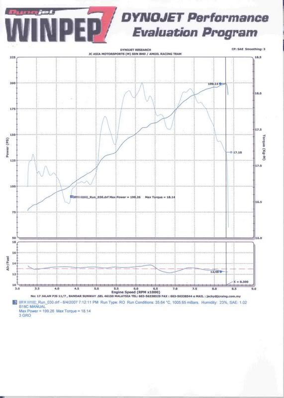

show ur chart to all of us lar.....
some of ours fren b18c 200 whp

he must have thought u are the thread starter. haha..... but wonder how he will know if ur clutch slipped? can tell clutch slip from dyno graph??
Yes you can, usually it's a very sharp drop in torque, due to power not being delivered to the wheels.
But a sharp drop in torque can also be caused by other factors, like misfires.
ic, so from the 200whp dyno, the torque also drop quite a lot, does it mean it's also clutch slip?
probably, but that's not my dyno chart, so that one is up to the observation of the driver and mechanic, but small misfires don't cause big gaps of torque losses like a clutch slip does, so unless if the misfire is excessive, so no, you can't usually see torque loss from small misfires, unlike clutch slip.
but IMO, it's hard to get a clutch to slip, unless the clutch is worn.. an organic clutch can take the abuse of a 200hp car easily. The stock R can accept 170-180whp without issue (half-clutch launches kill it pretty fast, so that's why you probably are seeing excessive wear)
As for the chart, it's a inertial dyno, so it has smoothing correction, and so it isn't exacly the best way you would use to notice clutch slip.. I think driving your car is a better way to detect clutch slip, as the point where the clutch is likely to slip is during gear changes, not a sweep run on the dyno.

For me, the dyno run is a tuning tool, and it's only 100% usable for troubleshooting if you can have the accompanying AFR and fuel and ignition maps, for at least 3 different runs.
Dynos try to replicate horsepower readings by not factoring in wind resistance, which can play havoc on horsepower readings, so ultimately they are just that, tools to measure horsepower in the most constant manner possible.
