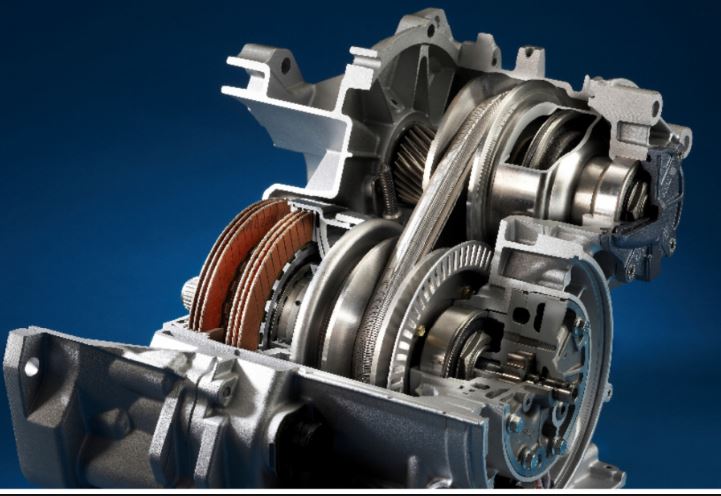

I own a Suprima CFE. This small turbo engine is quite nice to drive and somewhat responsive. It's torque curve stays flat at 205Nm from 2,000-4000rpm. Very useful when overtaking too, because you don't have to rev the hell out of the engine to get useful acceleration. Fuel economy is decent enough for me. I get about 7.5l/100km (avg speed 110-120km/h) on the highway and 9-10.5l/100km in the city (moderate traffic jam).
The CVT gearbox has minimal lag as it uses clutch plates to connect the input shaft to the gearbox. It's somewhat responsive too. Some manufacturers use torque converter in their CVTs. The downside of using clutch is that it's not as refined compared to torque converter based CVTs (like Honda's and Nissan's). Sometimes my car stutters/jerks when launching from traffic light. You have to let the car roll forward a bit, then only you press the throttle. Another thing is this CVT from Punch is not known to be very reliable. Some owners suffer breakdown (mainly bearing and gear teeth issue) even before reaching 100,000km.
http://www.zerotohundred.com/newforums/picture.php?albumid=3296&pictureid=11400
Yours is Suprima S? Charged Fuel Efficiency (CFE) Turbo CamPro IAFM+ 4-Cylinder
The catalogue claims 8.8L/100km though.
For the CVT, it uses clutch plate? I thought all automatic GB uses torque converter... Nissan Sylphy's CVT is very smooth.... basically, you can't feel anything during gear change.
