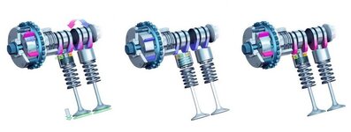

CPS use hydraulic tappet to do it. the inner tappet is always in-sync with the valve stem, but only in-sync with the low lobe when off
when "on" the inner and out tappet will be lock together by the hydraulic actuated sliding pin. since the outer tappet is in-sync with the outer tappet, the valve will be operated by the high lobe.
what kind of high/low profile (which includes timing,duration,lift) the lobes have is up to the manufacturer (proton, porsche, land rover), or even after market parts manufacturer.
thanks for reminding me of the valvetronic, but it's in the league of it's own, CONTINUOUS valve lifting (vs stages in VTEC/CPS...)
thanks for correcting, the latest MIVEC no longer provide variable valve lift.
while my previous post explain the difference of CPS (which uses the tappet) vs other cam lifting techno, take note most other techno use rocker arms (VTEC, VVL, MIVEC) to make the cam shifting.
CPS as use in campro cps is similar to porsche variocam plus, just that porsche also have the VVT (like i-vtec)
attachment.php
the middle picture shows "high lift", the little green part in the tappet is engaged, locking the outer and inner tappet. low cam not touching the inner tappet.
picture on the right shows "low lift", the inner tappet seems "protrude" out to touch the low cam in the middle. actually is the high lift cam on the outside pushing the outer tappet down without acting on the valve.
below is a bigger picture showing the "low lift". sliding pin in red not engaging.
the inner tappet ALWAYS contact with the valve.
attachment.php
