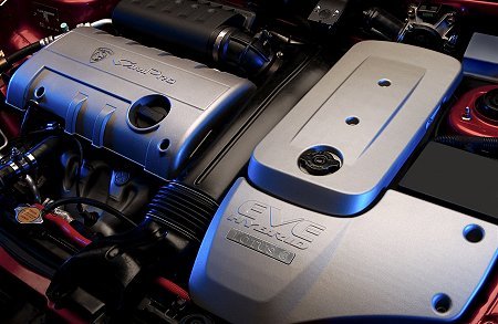

help me on this bro....and wad u think if i keep the 3k engine and put webber carbs...will it be enough to just drive around to college and all....thx again really appreciate ur time !!!
even if you put webers...you cant do much with such an old technology engine. I had a KE30 before way babk in 1990 .Damn good car! of course the sound proofing is terrible...it's not a new car. You can hear 3 to 5 times the wind sound louder compared to new cars today.
oh ok....but for just normal driving lets say at 100km/h to college and back home and mayb around my house to go mamak and all...is it a reliable car bro
