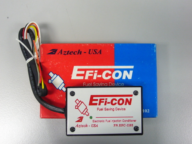

My friend fitted the 'Aztech' EFI-Con. 5 year ago and its result is good! It affects the a/f mixture and the exhaust oxygen sensor.
