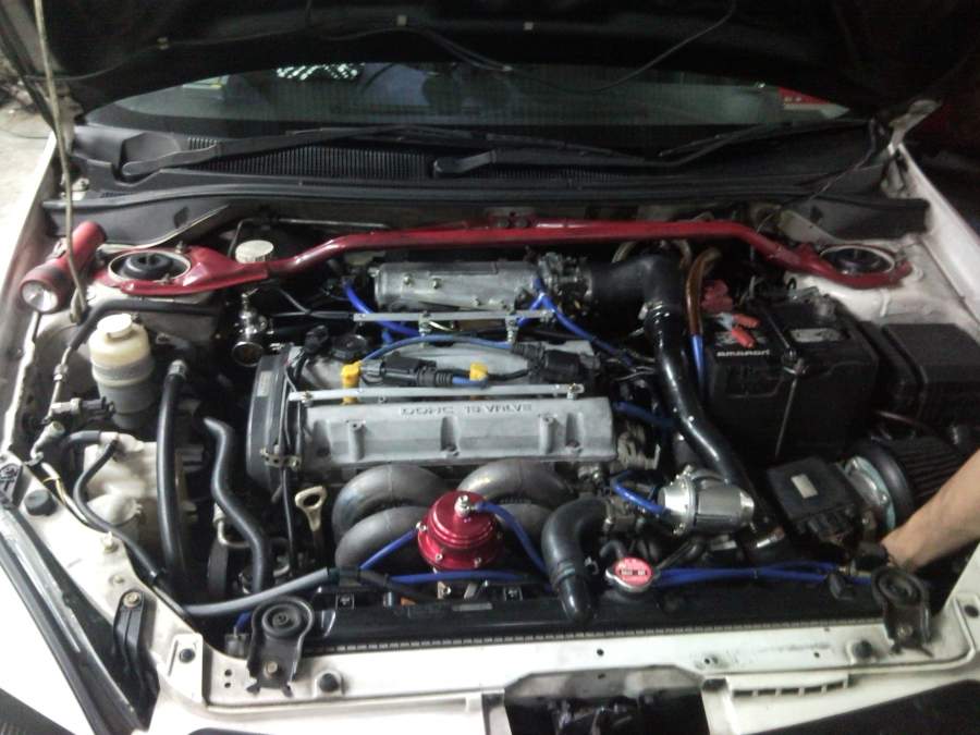

Anyone here know the difference between the 4G93t-CK version VS 4G93t-CB version??
CK version is what most call them engine terbalik compared to the earlier versions of 4G93T. This is the same case for 4G63T and 4G92 MIVEC as well. People usually call the newer versions as terbalik as their cam pulley and timing belt is located on the left (if you view the engine from the front of your car) while the older ones are located on the right side.
Both of these down here are the CK a.k.a terbalik versions of 4G93T.

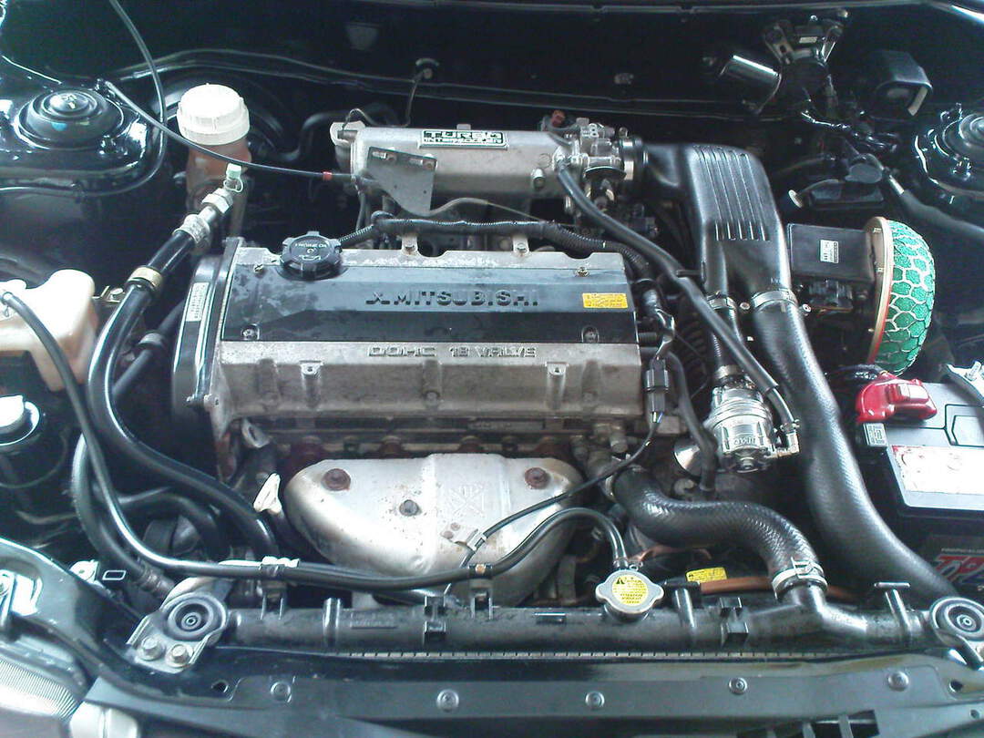

This is the older version.
The older version is what many people have use to fit into Wira, Satria and Putra as the mounting fits. The newer CK terbalik version had a different mounting so it is actually not legal to transplant those into Wira, Satria and Putra. But newer Proton cars like Gen2 and Satria Neo, I heard that the mounting of CK version fits in without much modifications to the engine mounting.

Love the Turbo Lag photo! :smile:
