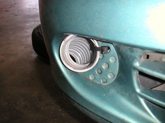

but i still doubt that the air goin through the hose is helpin...cause it needs to travel a distance to reach in our filter...sze try to use it few days then giv comment okie? :)
having the pipe travel along this pipe actually increases it's airflow velocity. to make this thing most effective best to use a bell mouth szekeiemme here can't afford more than the pipe i can offer :P [/b][/quote] im broke this month.. ehehhe will cut the bumper.. ehhehe |
the air travel thru de pipe is quite fast... ok.. compare to my old twincam pipe.. de distance is just 1 more feet.. means dat.. de original twincam pipe.. den at the end of de twincam pipe .. i addd 1 mroe pipe till de bumper oni 1 feet.. but my suggestion is.. use a smaller diameter piping la.. this is how i think.. 1st.. u imagine de coffee bean straw n de normal straw... with de same suction from ur mouth.. compare which 1 de air suck is more powerful.. the smaller 1 cuz u suck slow ma... but if u wana rev high n suck more more.. u use smaller 1 canot la.. ehehe can use bigger 1.. n suck .. so its up to u la which diameter u wan...i think mine will work / perform better when i rev high n top speed might improve...Originally posted by et5828@Dec 23 2004, 03:18
should be about 2.5 - 3" maxOriginally posted by ong@Dec 23 2004, 19:23

..maybe this site can give u an idea on it.....Originally posted by et5828@Dec 26 2004, 23:15
this is my freakin lousy diy cai...stanley..if i change my alu foil to ur superlon in this method..would it be better?..if open pod cai for kelisa how ar?
EdwardOriginally posted by et5828@Dec 26 2004, 23:15

Edward NO it wouldn't help much, the standard air box is better. [/b][/quote] edward... here is a little experiment for u... start ur engine.. turn on ur air cond.. den u feel de fan poweR! :lol: |
