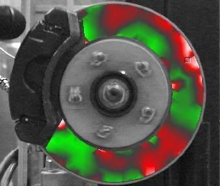

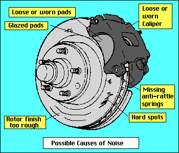

Eliminating Disc Brake Noise
and
Disc Brake Squeal
If you find nothing amiss (no worn linings, or loose, damaged or missing parts), then you can do all of the following measures to deal with the noise problem:
Dampen the pads
Lubricate the calipers
Replace the caliper hardware (slides, pins or bushings)
Resurface the rotors
Clean the brakes (use air-compressor to blow away the brake-dust)
Replace the pads
