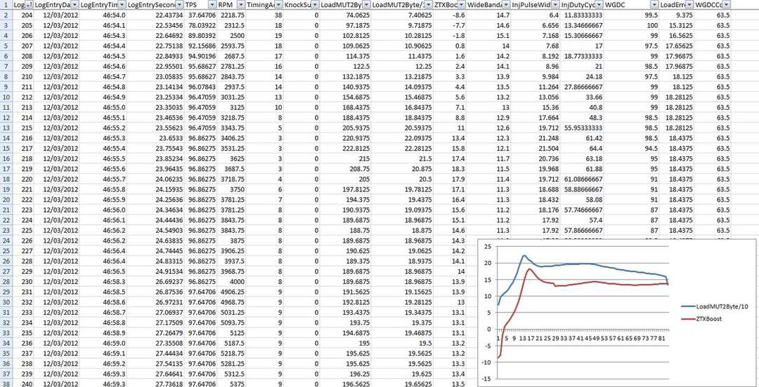

looks like it's still not quite there yet

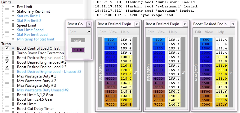

boost desired (load8) = 159
atm pressure = 100
load offset (load16) = 40
159-100+40=99kpa = 14.36psi
U can't be running 18psi stock at 3600rpm..?

This is correct, your running 14ish psi till 5krpm then drop to 13ish psi till 6krpm, after that 11ish psi. Max boost of 18psi is boost spike that last for 1sec as u can read in your log run, your boost cut at 200 load(160+40) when boost spike at 3.3krpm your boost cut delay is set to 4sec delay so u will not feel like hitting a wall at that rpm, after 4sec your load had drop under 200 becos u gain speed + wastegate open back up n holding at 190ish.
How the ECU control boost is depend on desire load not how many psi, u need to adjust your load offset to increase boost n boost cut, then set desire load at any giving rpm, just use the same calculating formula.( load may very between air temp, gearing, weight etc so there only ''ish'' psi )

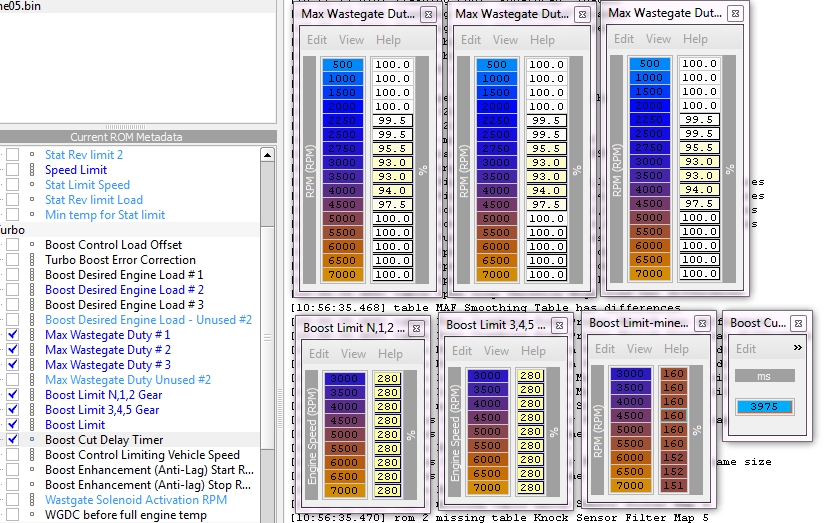

oh man... just found out two tables sharing the same address... doesn't look right...
Update for boost limit table.
yes. as I understand the boost limit table being used are the boost limit n,1,2 and boost limit 3,4,5. the boost limit table itself is not used (afaik).
Yes.. this apply to all table like boost table 2 is n,1,2. table 3 is 3,4,5. fuel map table 1 is n,1,2, table 2 is 3,4,5. etc...

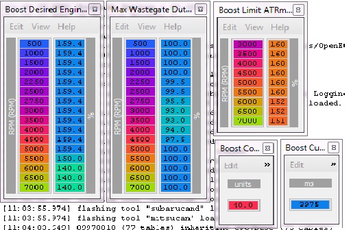

Have u start tuning your boost..?
the value on the 'boost desired engine load #2' is already maxed out. the way to increase it further is to increase the 'boost control load offset' which i'm currently reluctant to do since it might affect other variable.
might be perfect to run boost average at 14psi anyway, since (afaik) the stock turbo will start loose efficiency at 17psi which i have as the peak. what do you reckon?
might not have time to do much these days due to other commitments, the next thing i want to do is playing with the open loop threshold, and tuning timing/fuel further.
Yes.. will effect boost limit also... the way to do it is to lower all load value while increase offset. Its down to what u doing with your ride, daily or weekend warrior... If daily, keep the stock boost, fine tune fuel n timing...
