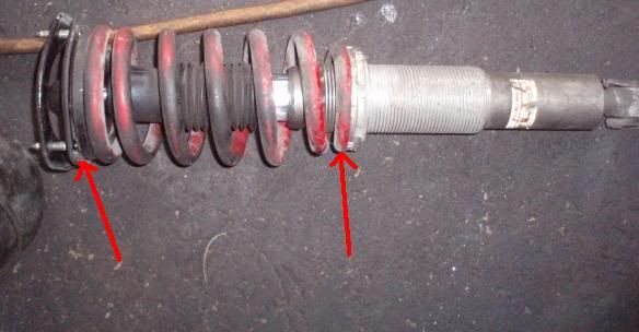

if u using adjustable, the sound maybe is caused by the 'seats' of the springs, if u get what i mean.
the area where the top mounting bolted on the body?
not really that area, cos the body weight and the 3 holding-screw
is tight enough to hold it in place.
i'm refering to the area pointed by these 2 arrows in the below pic.
