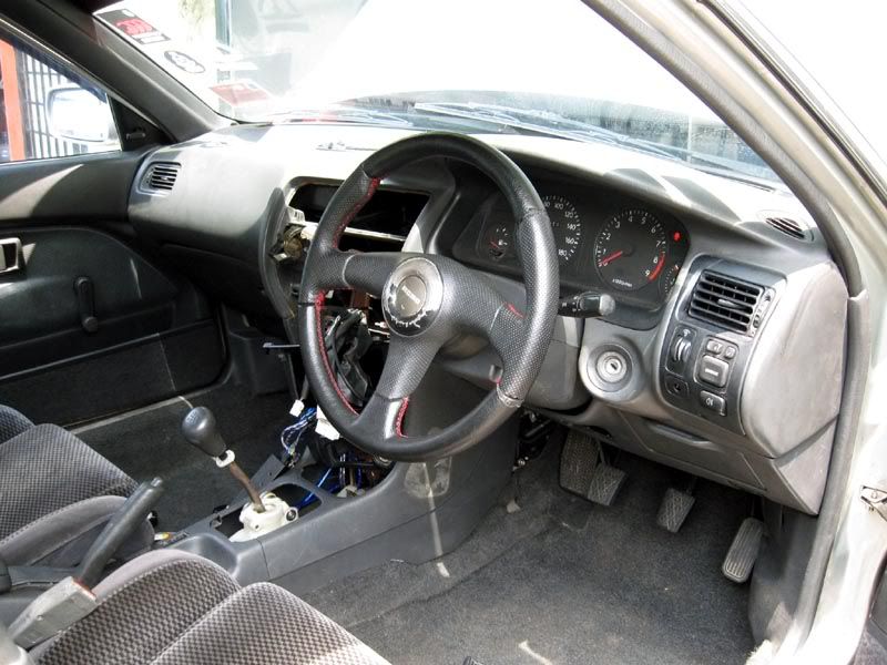

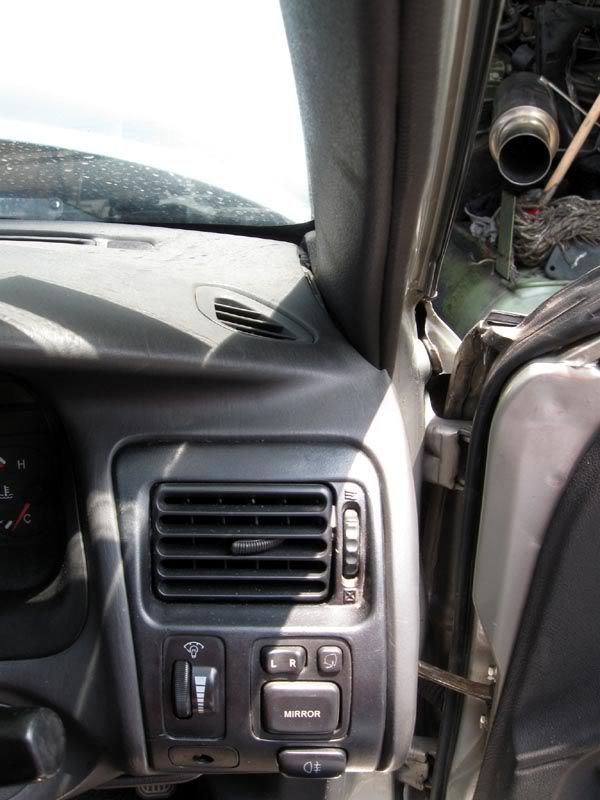

here are some examples for ae101 stock dashboard
example :

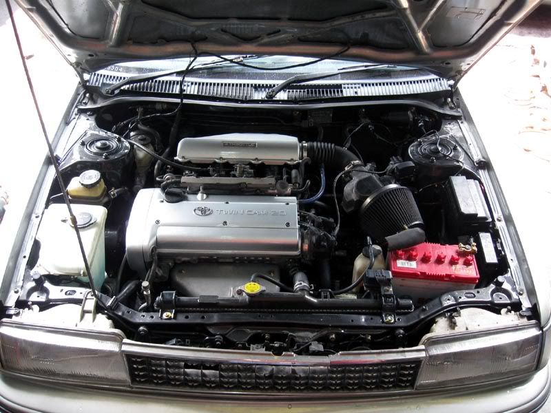

engine bay...
modded as the engine bay looks like original AE101 or AE111 engine bay... :D :D

Put on the dashboard....more cun weh...melengkung...............
opsss sorry...the above picture was stock AE101 dashboard...my bad...
all dashboard from ae1** series can be fitted...not problem at all...
