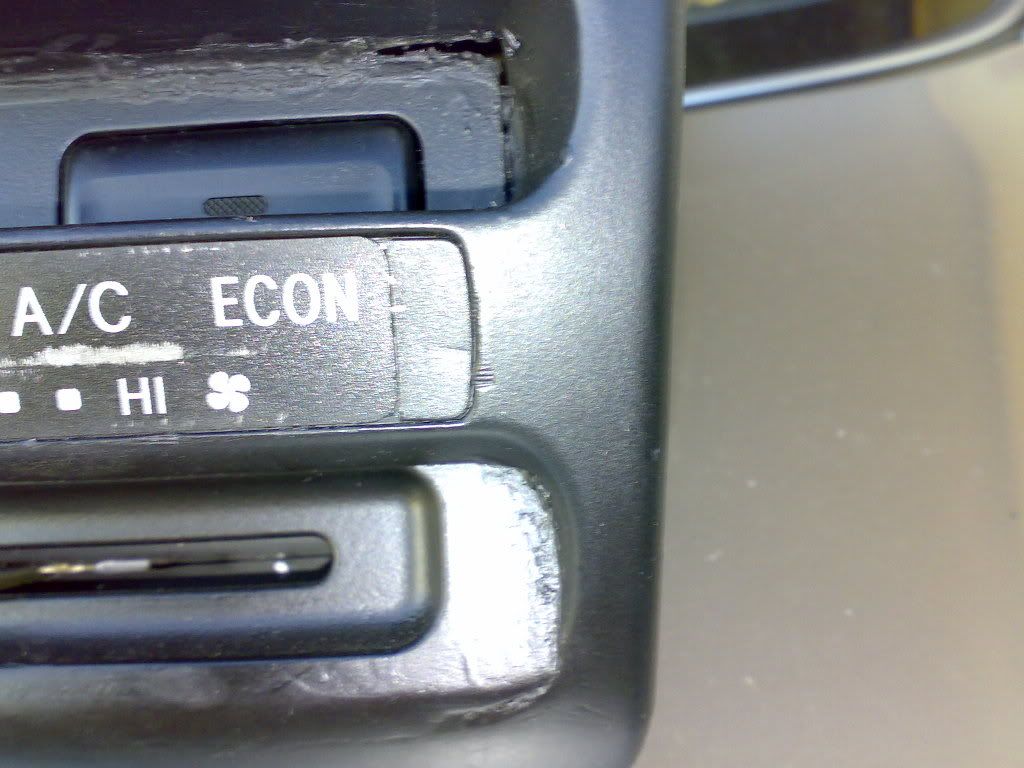

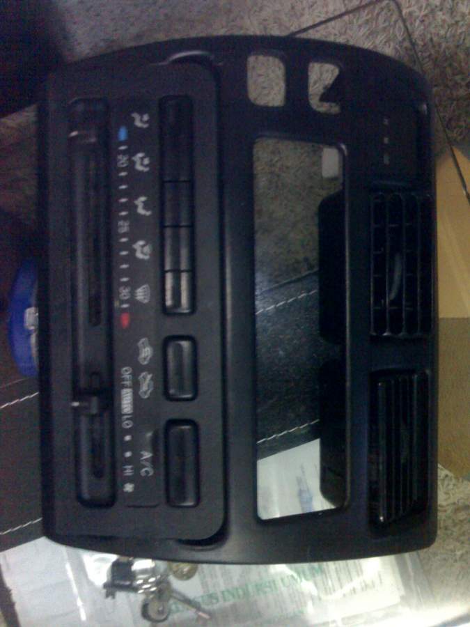

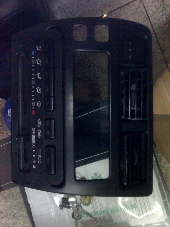

what about my modification. is it okey? ae111 a/c switch fix to ae101 local dashboard.

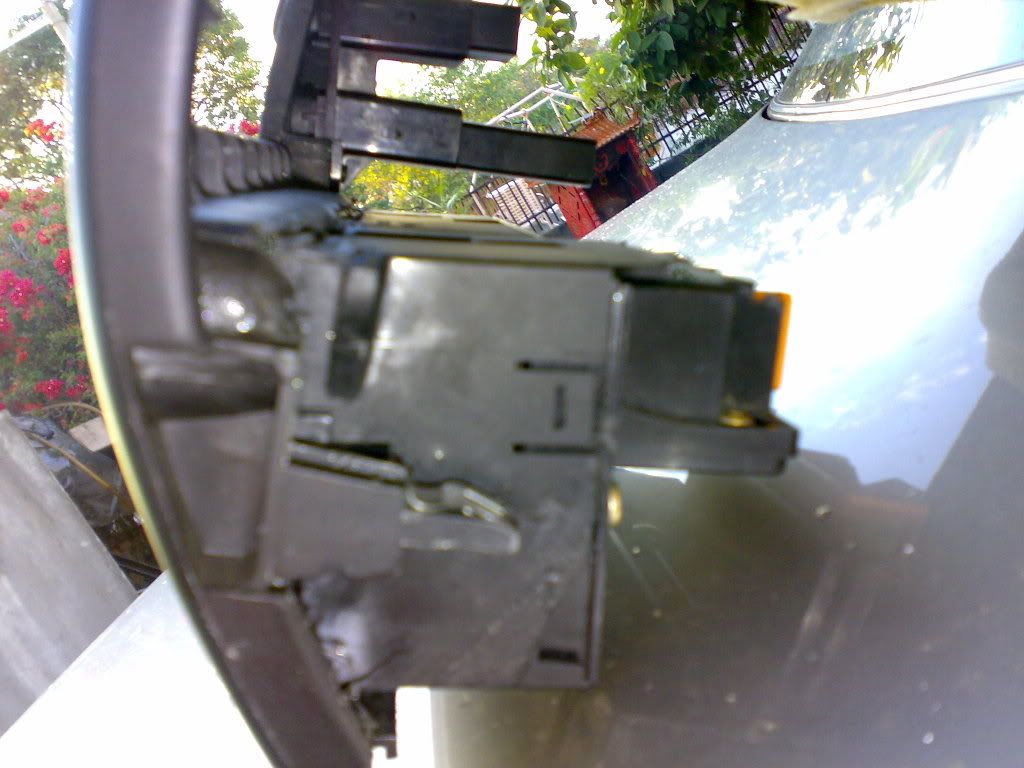

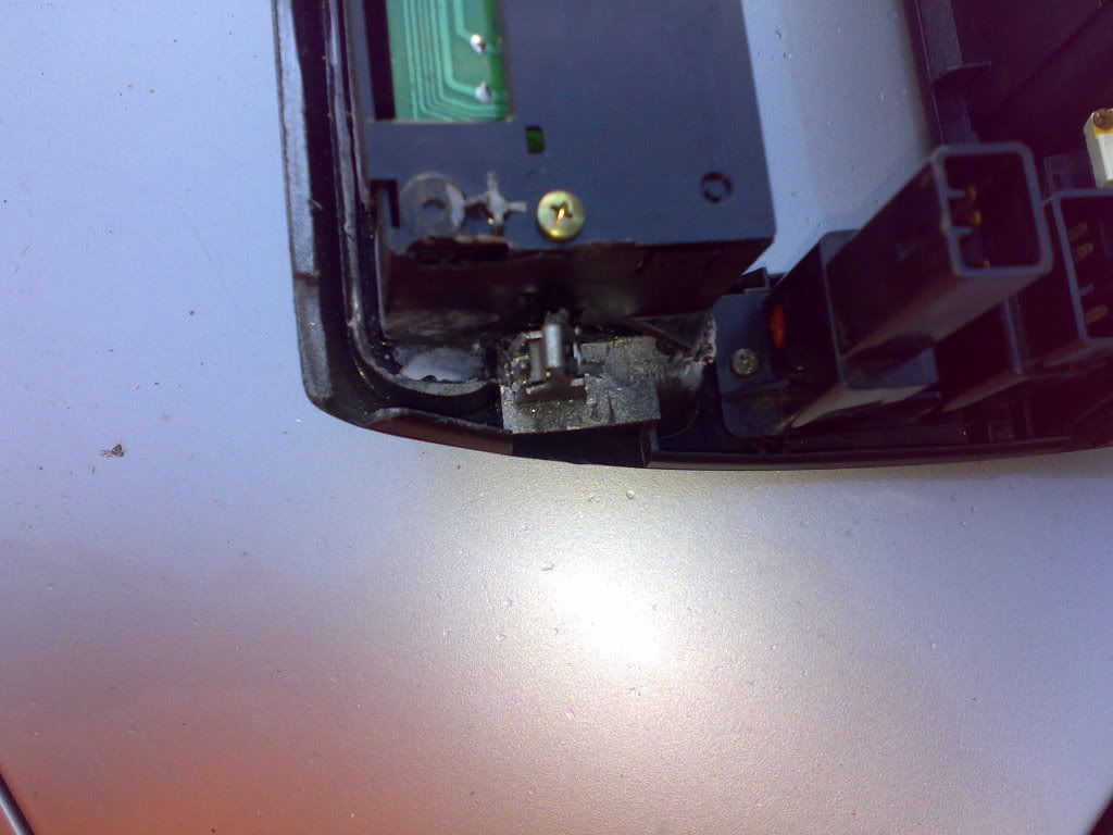

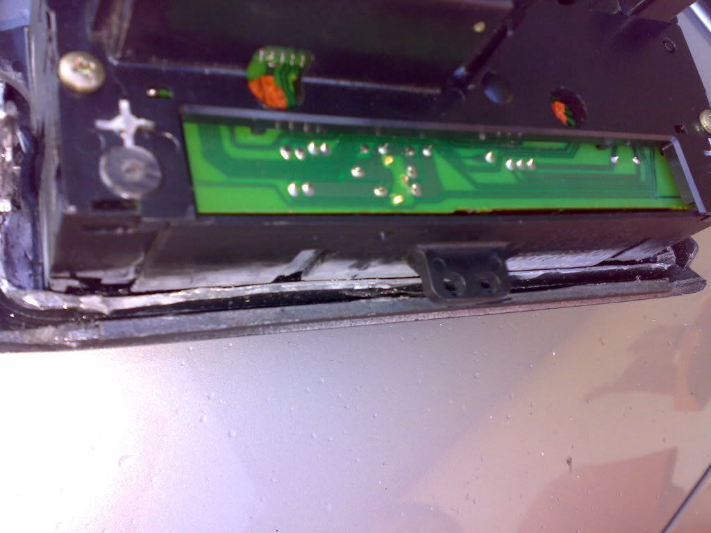

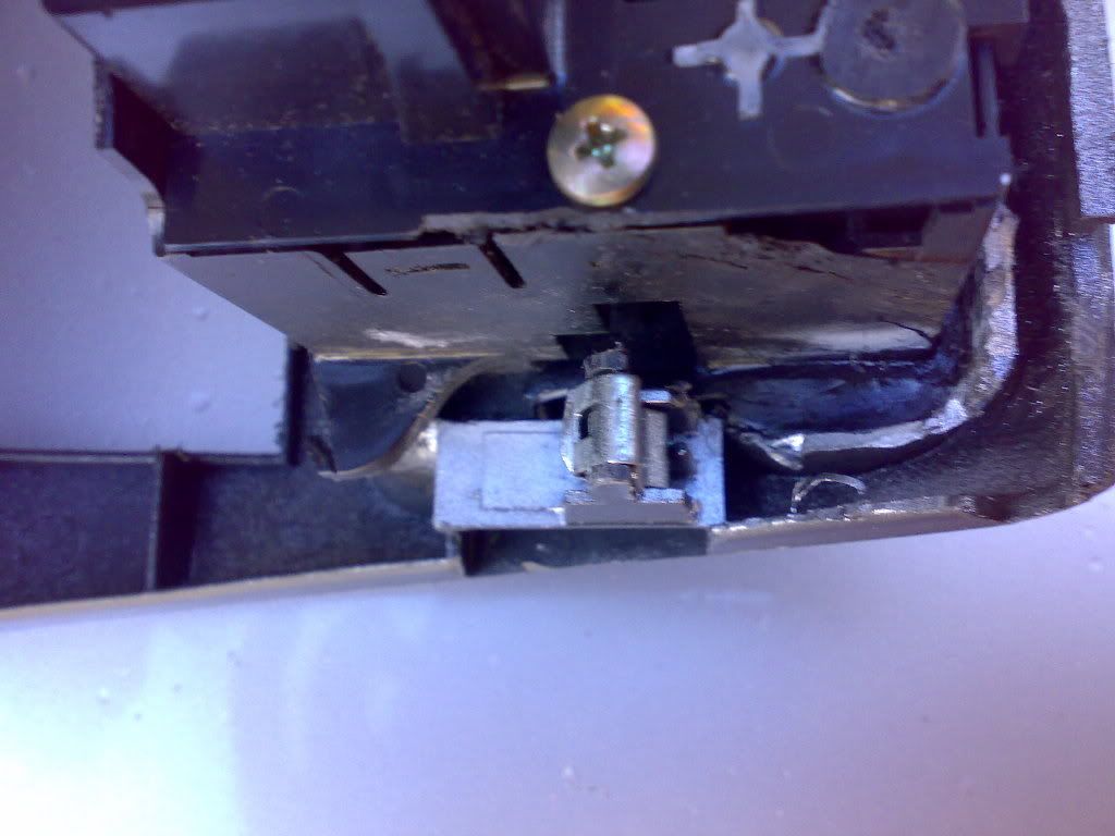

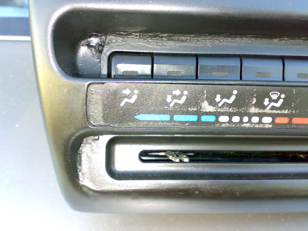

it depends lah.. this is what i did the first time, mine is put the switch behind the ae101 panel.. i upload the pics now lah.. hehe...
Bump: surface a bit dirty coz didnt clean up the filler n sanding.... will sand the surface smoothly when got time...
mine, i directly cut the ori panel measure the ae111 switch to fix to ori ae101 a/c panel. i put in front like we put radio to the panel. but must cut it carefully. salah cutting tak cantik lah. after that i gum pakai hardex half hour punye sebab memang kuat gum nya.
before you stick the switch, better make sure the socket area doesnt touch the radio... when i did the first time, the back of the switch area-socket area, block touch the radio n cannot fit in nicely.. need to adjust the angle a bit...
if u do like mine u will fit it nicely. never kacau anythng backside. it is like the ori ae101 switch.
