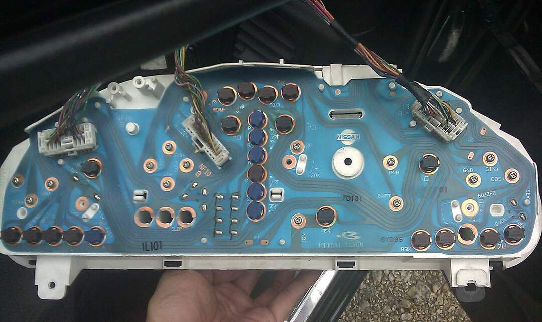

yours is digital, i am not sure if it will work. cause if you dismental the back of the speed meter, there is some dip switch which is already solder, the setting maybe is universal for mph, kmh and 260 to 180, difference dip switch setting will give difference setting. maybe you can try compare to your 260km meter dip switch and try use the same setting.
Hi Weikee, need ur help to identify which is the dip switch, attached photo of back of meter panel.
:adore::adore:
I dint see any switch that can be adjusted cos all are soldered onto the circuit sheet.
This is not dismantle complete, you got to dismantle the meter, take the speedo unit out, and inside you should see it.
Dismantle it out till you need to take out the speedo needle. This one is a delicate job, make sure you don't snap the internal spring, once the spring snap your speedo will "dance" freely.
