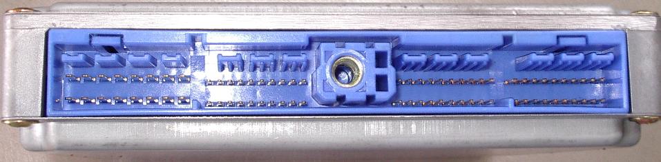

How can be the same number of pins and location if Cefiro has only pin 1-116 and Maxima & Infiniti have more than 116 ??? look at the Two different ECU below!!
UC, not sure we are in same channel, anyway the ECU in A32 have more pins, same goes to all newer Nissan ecu. I use Maxima ecu pin out to find some of the signal in my cefiro, is not 100% match, some i got to trace back (i mention this too earlier in this post).

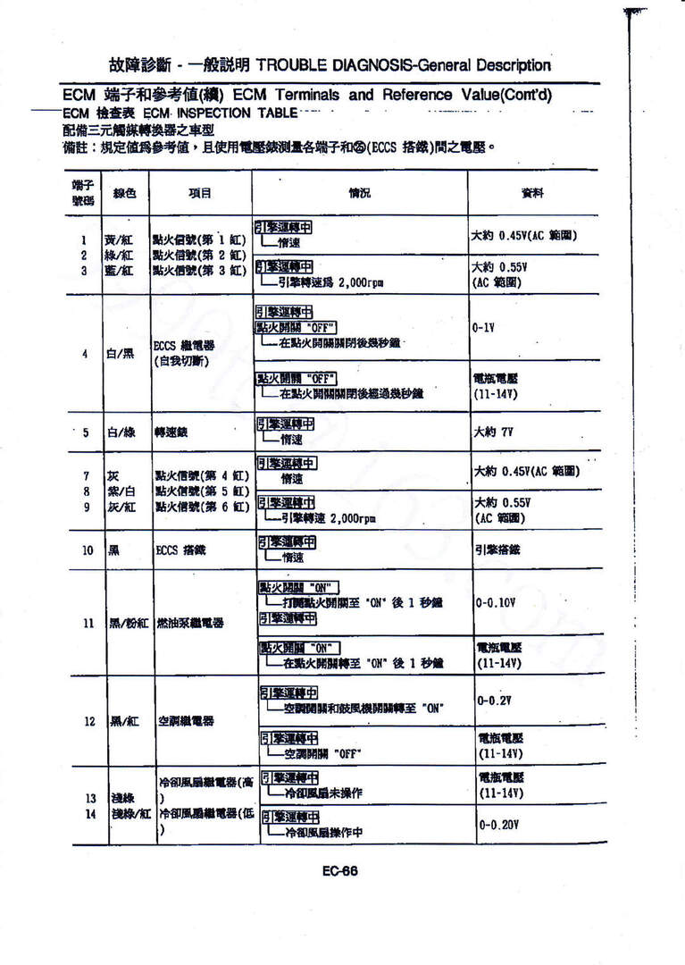

please check both diagram shows different plug type for both ECU you shown to us.... as u can see from the different page numbers, EC-72, EC- 252, I took them from different manual...... i dunno whether i might help you but this is what i can offer.....
please match both diagram with both your attached ECU pin out before you come back to me.... Also, attached is the Asian version ECU coding, u might ask somebody to match it for you, but as far as i checked last time, it is all the same.....
1stly bro almeshtaq, i didnt claim that Asia ECU have 124 pins.... they have pins up to no. 124 but there are some missing pins in Asian ECU..... Also,A SAME THING BETWEEN BOTH ECUs IS THERE IS NO CODES FROM NUMBER 81 - 100.... thus, eventhough US version has 116 pins in total (as u stated), there is a pin coded no. 124....
After my calculation.... the asian ECU (the blue one in your attachment) has 84 pins, total of four sections,
1st sec - from pin no. 101 to 116 -16 pins
2nd sec - from pin no. 1 to 20 - 20 pins
3rd sec - from pin no. 21 to 40 -20 pins
4th sec - from pin no. 41 to 60 -20 pins.
missing pins in Asia A32 ECU - no pins for 61 to 100
US version has 116 pins (the 116 pins that u stated) (As attached in your picture which was hold with hand) , divided into 8 sections ....
1st & 2nd section - from pin no. 101 to 124 (horizontally) - 25 pins
3rd & 4th section - from pin no. 1 to 19 (horizontally) - 20 pins
5th & 6th section - from pin no. 20 to 43 (horizontally) - 24 pins
7th & 8th section - from pin no. 44 to 80 (horizontally) - 47 pins
no pins missing in US A32 ECU
Bro almeshtaq, please stay calm and check whatever i said before you make a statement..... I had spend day and night trying to solve your problem without any benefit...... I might just leave my keyboard from this thread, but im still staying here and trying to help. Thus, even if i had make a mistake, you might point it out for me.... the quote above is really a distracting one, I hope you understand..... tq....

yeap u get what i mean, the Infiniti !30 or Maxima ECU has more pins (116 pins) compare to our Asian version so-called flat-layout ECU ( 84 pins). I had stated that the wire number and colour codings seems to be the same...... i will upload the Taiwan version of ECU coding lists this afternoon (in the same manual which i uploaded my ECU diagram pic stated "Engine ECU Diagram for "WY"), the "WY" is marked on our ECU as shown by you..... but i cannot guarantee that the Taiwan version ECU will have the exact pins coding and location with our ECU although both also has the same pins layout..... but as i seen in the net, the taiwan version of A32 engine is the same like ours (which has a big intake body, so-called MEVI i think) and not the USim version ( which has 6 intake pipes instead of body)..... so i just ASSUMED it to be the same
UC, my ecu is the newer version (with more pins). Even the 1/2 cut i got from japan is also using the newer ecu.
Weikee, if u can show me the picture of the ECU then it would be better..... but what i attached is to match Almeshtaq's attached ECUs, so it might be different from yours..... u can match both my diagrams ( "WY" version and US versiondiagrams) with both ECUs picture that he shows..... as he said, he HAS the "WY" version ECU (so that is the earlier version A32).... Also, the title for my Asian version Cefiro manual is for A32 from yr 95 - 98, for VQ 20 and VQ 30..... since i dunno what year your halfcut is, also dunno VQ what.... so i might not know whether they have any differences.... so spare me.... thanks.... but at least i have to fulfill almeshtaq's enquiry....
attached is the Asian ECU Harness Colour and ECU Pins Coding Lists...... for A32 VQ 20 and VQ30 FROM YR 95 - 98.....(please, i dunno whether it match JDM VQ25, or A32 earlier than yr 95 or later than 98, it is stated there 95 - 98 A32 for VQ 20 AND VQ 30, so you all might check it yourselves) pls check.....
