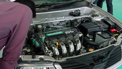

PETRONAS E01
Valve mechanism: Continuous Control VVT (Variable Valve Timing)
Camshaft: Double OverHead Camshaft (DOHC)
Displacement: 2 litres
Induction: Natural Aspirated
Cylinders: 4, In-line
Valves per cylinder: 4
Block: Aluminum
Weight: 108.9kg
Max Horsepower: 204.3 PS @ 7300rpm
Max Torque: 203Nm @ 5300rpm
Power Output per litre: 100 PS/litre
Volumetric Efficiency: 107.8%
Emission Standards: EURO 2

dunno.... got people using this engine in malaysia??.. if got also vr rare rite??... its not mass produced and widely used here...
but still, it is a wonderful engine, no doubt...

I heard that this engine once introduce to Proton but then... Dunt know what happened.. What a waste.. :hmmmm:
Kind a cooperation between Petronas and Proton.. :creep:.......... :shakehands: ......... :vroam:

there are only a few cars using this engine on road in malaysia... mostly belongs to petronas...
produced by petronas... they offered proton the contract... but the clever CEO turn them down... so now this engine found his place in china car....
