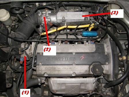

Picture below no.1 is ignition coil. Coil faulty is unvisible outside only the worse i heard is getting melt :smokin:

owh, that one we call coil. two screws holding it to the engine right? one hole has screw and the other one doesnt, just uses some sort of clip because the previous screw snapped and stuck inside, cannot put a new screw. Is that can be the cause? maybe because it is not fixed properly on one side, has some gap
