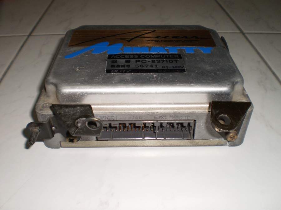

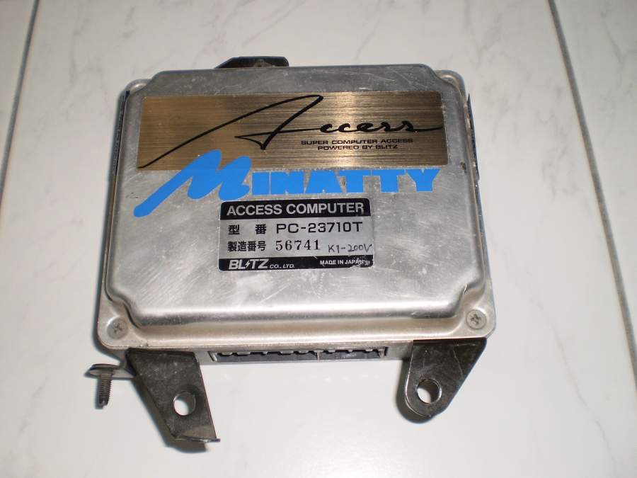

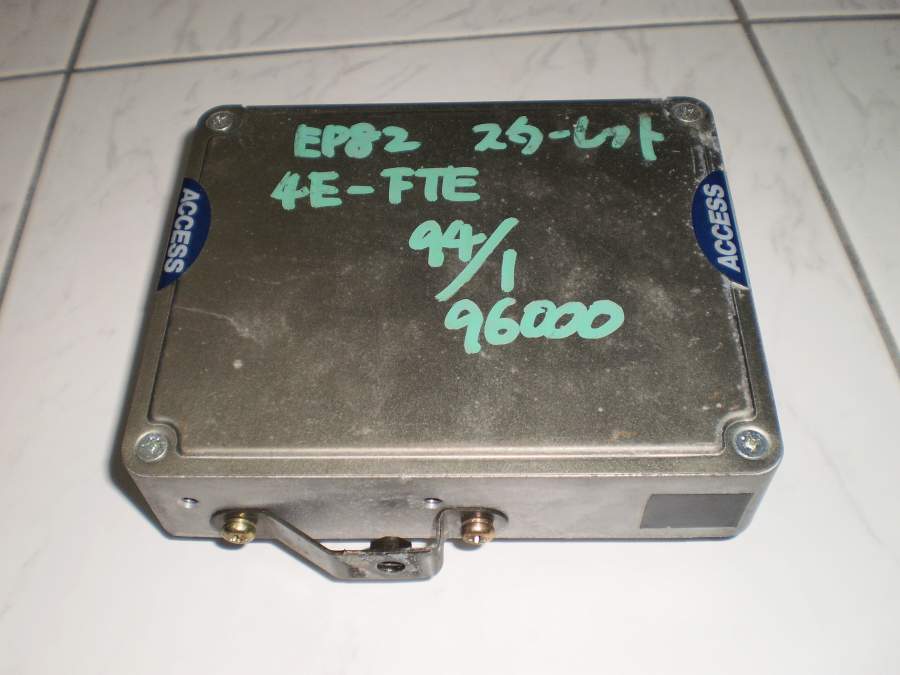

Anyone seen this ECU before for EP82 4EFTE ?
Any specification and details about this ECU?
I was told that this ECU can boost up to 1.2bar. Anybody can confirm this ?
Thanks !

different ECUs have different tuning specs. blitz have off the self unit for stock standard and also thier own turbine setup. there also are instances where they custom tune for japanese customers.
by the looks of it yours probably has the standard blitz access features (speed cut / rev cut / boost cut / aggressive fuelling etc.). if you look closely at the sticker you can see next to the number 56741 got a code written in marker pen right? that would answer your question. this particular unit is tuned for a blitz k1-200v turbine setup. and can only use on ep82 (square and quad light) engine but not on glanza as glanza has different number of sockets. you should be looking at 190bhp at the flywheel with this setup.
http://www.envyperformance.com/inde...Product_ID=2076&CFID=1857280&CFTOKEN=52240221
hope this helps.

That's very useful information ! Thanks bro !
