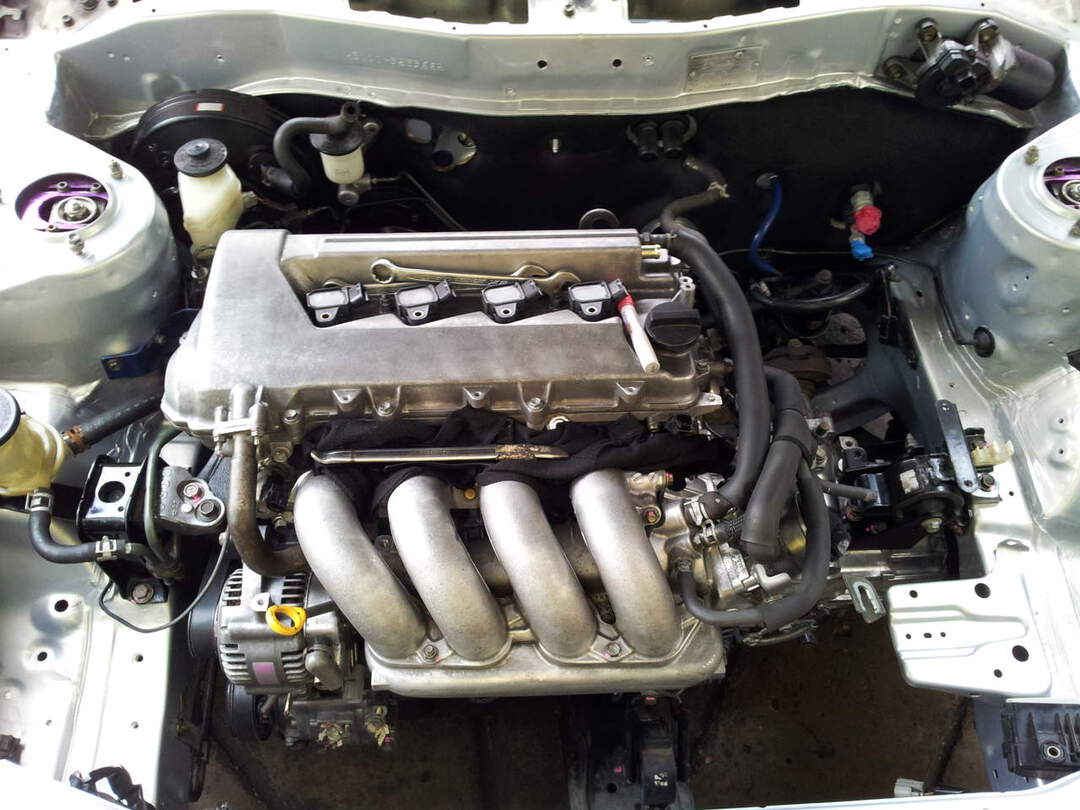

2zzge swap on a AE111?
Marbeles!

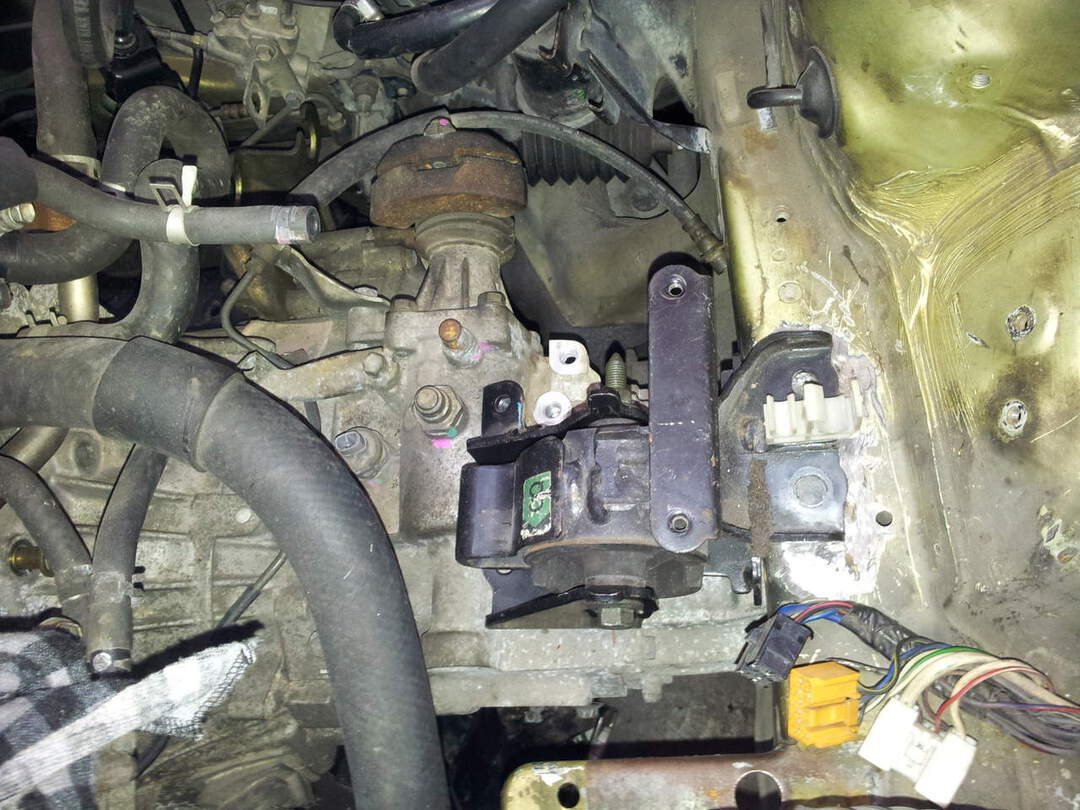

The engine mount on timing chain side need to zoom in a bit, pic not clear, hehe..
as per request...:biggrin:

The mount I bought is for the AE111 from the U.S that has a 1zz engine in it.I'll also be purchasing the engine bracket for it as well.
Here is my dilemma
which one is for the 2zz mount and bracket I need to purchase?
which one below is for the 1zz mount and bracket?
Which one must have the 1zz and 2zz mount and 1zz and 2zz bracket?
Front mount?
Engine bracket?
Rear mount?
Engine bracket?
Left Mount?
Engine bracket?
Right mount?
Engine bracket?
The axle I'll be purchasing is both from celica SSII and the U.S version AE111 since from the list said its 1zz inner and 2zz outer.
All of the parts are brand new. I just don't trust the used parts anymore.lolz
Thanks.
