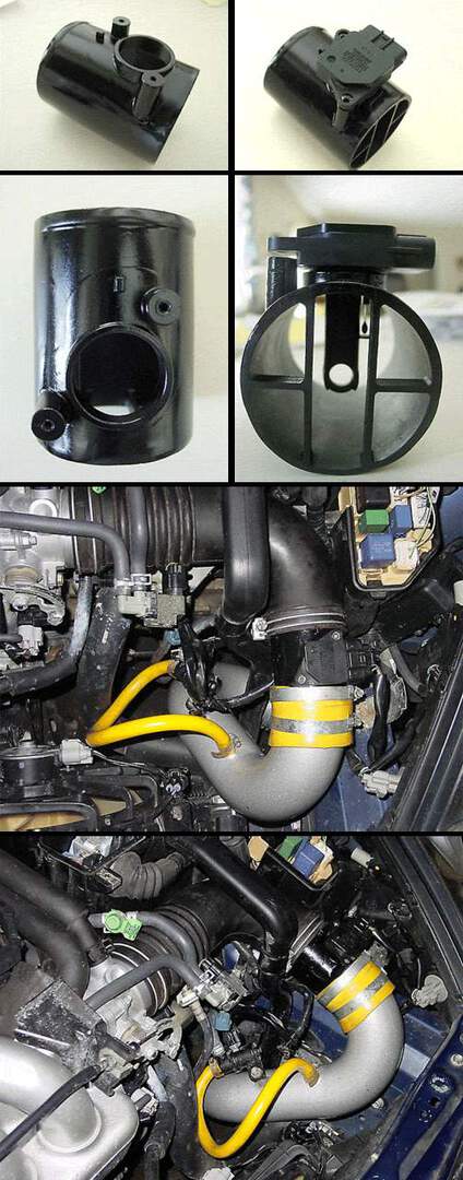

attached pics show it, and a good way to mod them for open pod SRI or CAI...:burnout:
even the diameter you need to maintain especially after it..
going bigger would need piggyback to refine the AFR...

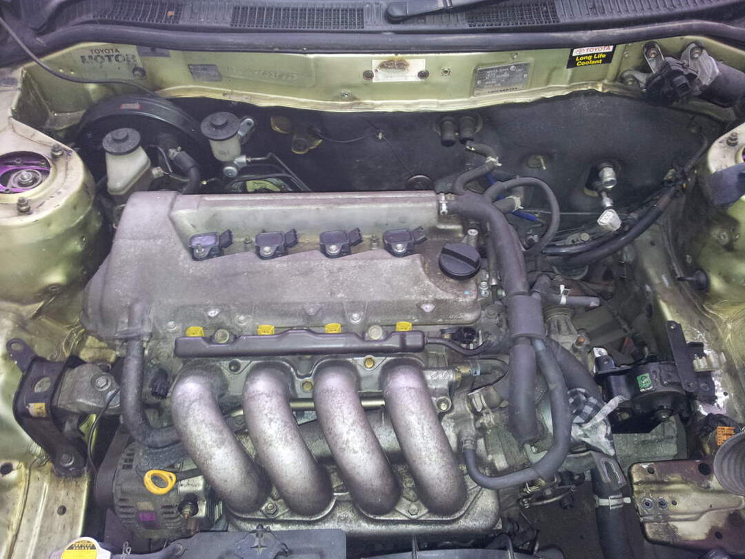

a slow built... since its old already...:hmmmm:
custom header...
since there're quite a number of people already ventured into this route...
my mech able to get them from his usual fabricator...:biggrin:
