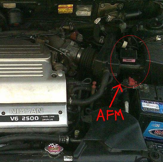

This is Air Flow Meter (AFM) taken on my VQ25

Air flow sensor that sense the speed of air being sucked into the manifold? A33 one looks so different.
