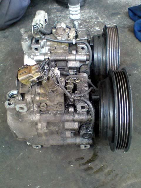

hello everyone... anyone solve the problem yet? i'm still facing the same problem... compressor change...belting just change NEW... refill with new gas... the air cond sensor change... damn... it still blink~! help.... mine is 4age 16valve small port..not 20v.. paiseh paiseh.. advise really needed..thanks~ :biggrin:
r60262
Mar 23, 2006
282

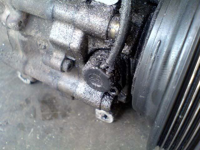

just to share. dun know it true or not. it happen to my car. same like u la.. my compressor plate (engage disengage funtion) missing. pomen modified with other plate. ok but not perform. lastly change compressor..ok..

still cant slove the problem.........change compresser , relay , also cant slove.........anyone got a/c panel to let me..test??heheh
