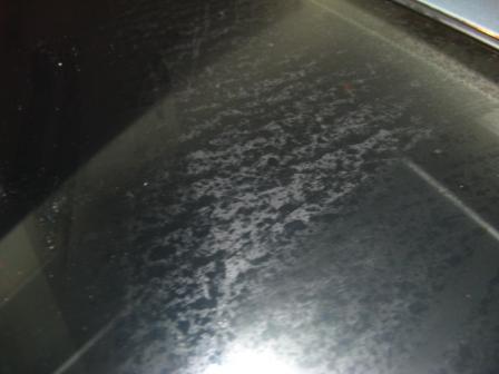

Here is a pic after cleaning the glass with ONR. You can clearly see watermarks/spots all over the glass. ONR stands no chance in removing the watermarks.
Figure 3: After ONR wash, watermarks still visible

Figure 7: After washing off OPC 1:3, water streaks clearly visible. This bothers me the most.
After drying... watermarks/spots still there. Already done several OPC 1:3 cleaning and wipe downs but to no avail. Guess the water marks is already etched in.
Figure 8: Water marks still visible after OPC 1:3 cleaning

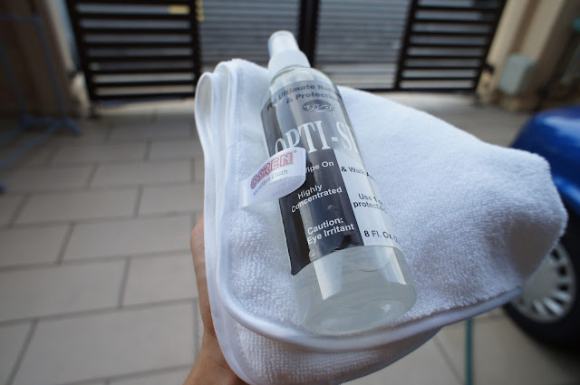

And lastly, the final protection with Opti-seal and the short nap side of Osren's premium MF towel.
Figure 16: Opti-seal for protection
