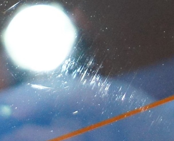

Here are some pics of a condition that you should avoid using acid based watermark cleaners (besides it being dangerous to handle) as consulted from bro Henry @ Osren. Take note that I have already removed the watermarks on the rear windscreen. Whatever that is left behind are scratches and pits which is not possible to remove with my techniques above. Acid can get into the crevices of the scratches of the wiper blade area and cause hazing and poor visibility. Also indicates why you should always try to keep your car clean. Don't forget to clean your wiper blades properly and regularly. Even if glass is harder than paint.clear coat, it can still be scratched! The more the scratches and the deeper it is, the more streaks and poor visibility during a rainy day. Same goes to those who use opti coat on their paintwork, it is not a bullet proof or permanent coating. It acts as another layer of protection that's all!
Figure 21: Rear wind screen, tempered glass with wiper blade scratch marks
Figure 22: Zoom in of scratch marks
