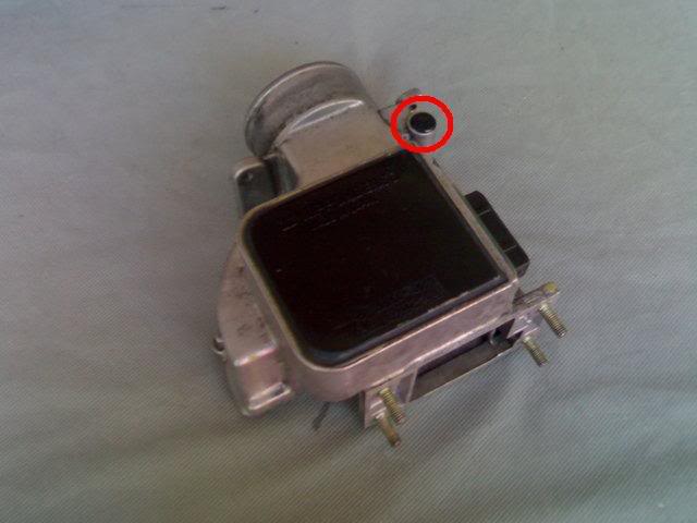

What is function of the screw at AFM? I remember last time when idle suck during aircon on, the foreman re-wired aircon vsv (maybe the vsv did not switch on). After wiring done the idle still suck the he adjust the screw at afm. SO what actually the screw use for? Some said do not touch the screw.
---------- Post added at 11:49 AM ---------- 6 hour anti-bump limit - Previous post was at 11:38 AM ----------
The screw on top of AFM is the bypass valve from afm flapper ... it would help to slightly adjust the idle fuel mixture

So it is for air fuel ratio tune right?

It decides how much air bypass the AFM flap before go into the engine (not read by the ECU) so will have some effect on the A/F if you adjust it.
Some sifu here have tried to mess with it but ended up no significant result.
Any how it is for emission (CO) adjustment only NOT for other purpose.
