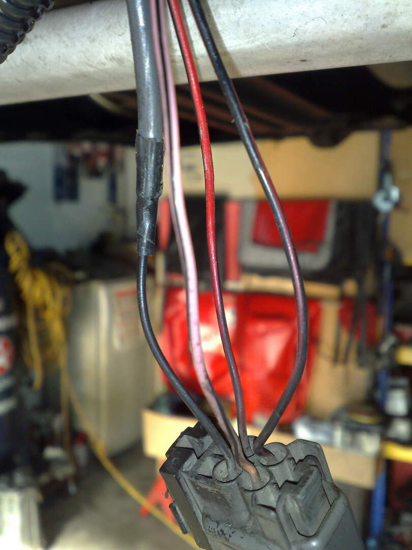

Hi all,
Pls help, I'm a bit confused coz I got myself a new O2 sensor and the wires are :-
1 white (signal earth)
1 blue (signal)
2 black (heater)
my current O2 svt stock has got :-
2 black
2 grey
before the socket, a totally different set of wire colours :-
1 Big grey wire join to a black wire to the socket
1 Pink black
1 Red Black
1 Black red
Can anyone teach me how to connect my new O2 sensor to the old wiring? Pics below..

Hi Sifu wong,
Yes it was but since I bought the new O2 sensor, it only has :-
1 white
1 blue
2 black
So my questions is which wire from the harness goes to the new O2 sensor (pic below)? Thanks.

O2 --> Hardness --> ECU--> New O2
black --> pink black --> HT --> black
black --> black red --> +12V (IG SW) --> black
grey --> black/big grey --> OX --> White
grey --> Red black --> OX+ --> Blue
For SVT, the ECU sense the low side signal (signal earth) of the O2 sensor.
Therefore, white wire should be connected to OX.

Levin818 - Right on...is the wiring connection works ?
Here's some of the pin connection picture :
1 - grey -> black / thick grey
2 - grey -> red black
3 - black -> pink black
4 - black -> black red

But the pin orientation has something wrong le. Black/thick grey should go to pin no. 3 right?:biggrin:
Correct me if i'm wrong ler... :smokin:
SVT (O2 sensor) -> BT (harness)
1 - grey -> pink black
3 - black -> black / thick grey

SVT 02 sensor have 4 wires,the colors are
Pink black = Heater control - connected to ECU
Black red = +12V supply (IGN)
Black/thick grey = Sensor signal output to ECU
Red black= 1V voltage supply from ECU

Thanks for all your comments!
Didn't know that it's this complicated and there was a difference in the O2 reading for svt and bt...well than I apologize for not informing earlier that I'm using a 5sp BT Ecu with SVT harness and just got the new O2 sensor. Previously using SVT O2 sensor.
This is the only info I got from the supplier of the O2 sensor..
black -> heater
black -> heater
blue -> signal (+)
white -> signal (-)

Then it is correct that Blue is OX and white is signal ground.Just connect it that way,i already mod your wiring to use BT O2 sensor.
