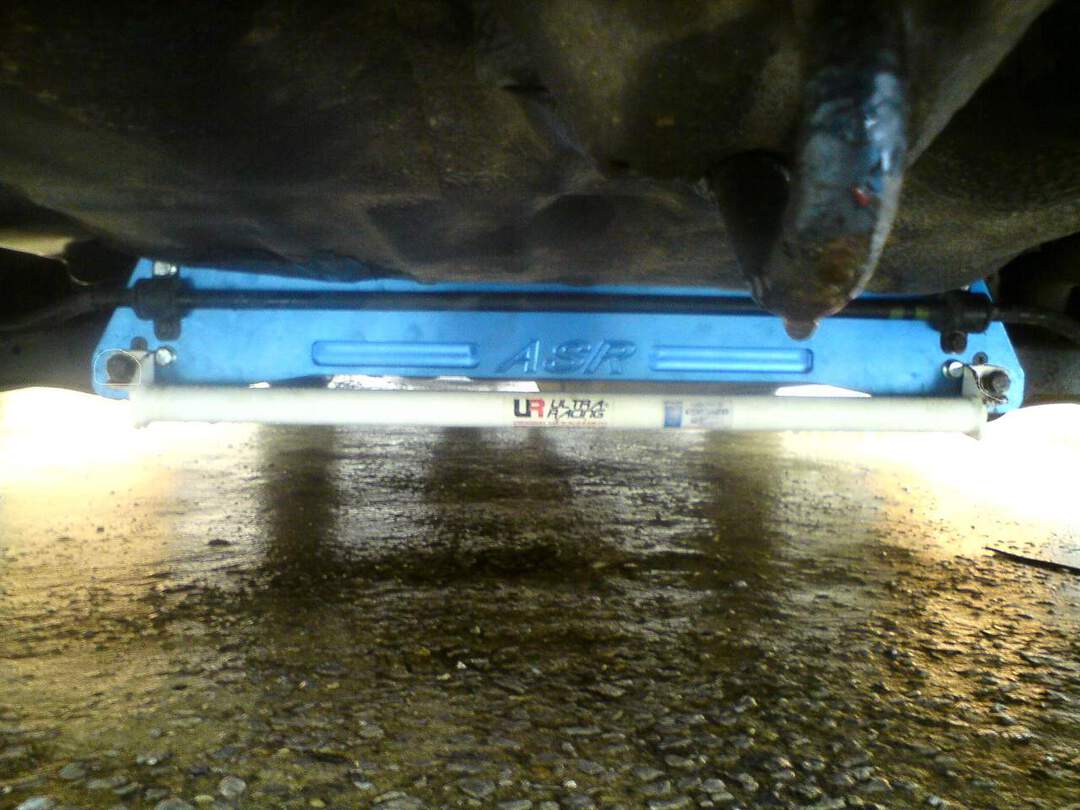

The asr isnt a subframe replacement...its a brace...u add it on to ur current subframe...
As for the subframe tearing, as far as i know that only happens to civics due to the thin sheet metal used...especially to EKs it seems...even the EGs are suposedly more resistant to tear compared to EKs
Never heard of integras having the subframe tear issues, coz if not mistaken the subframe on integras are thicker n stronger
i am afraid of this problem to bro madman, from ur point of view, install those bling bling brace bar from asr something will more resist those tear or using UR rear lower arm bar will resist also?? cause nid to know this before upgrade rear anti roll bar , now i stick with stock 13mm ARB only cause scared of the tearing issue,i pan to upgrade UR ARB (18 or 19mm).......... since u know eg almost 18 years old and metal do have it's aging limit before fatigue......(or i am worried too much by learing too much engineering,lol :stupid::stupid:)..... i now have almost full UR bars except the REAR ARB, even the fender bar,when install, driver side already not so accurate in position , got run 0.5-1 cm... scare of fatigue chasis...
mADmAN
Aug 5, 2004
1,840
547
3,213
One of the first mods i did to my car was the ASR brace....but replica la..not ori...i installed it even before i saw the car. So yeah, id recommend it....
But if ur going for UR ARB, no need..the 19mm should still be ok for the eg....
Personally, i wouldnt bother with the UR. U can get the 23mm dc2r for cheaper...i used to have the UR n then sold it off after i upgraded to the dc2r..n it was a world of difference for me...car felt so much more planted on corners...but take note i also have the dc2r front anti roll bar.
Only downside of the dc2r arb is the fact that the subframe brace is a must....which kinda makes the whole arb upgrade slightly more expensive than the UR arb...and also its not as easy to get as the UR which u can get almost everywhere..so depends on how much u wanna spend oso...
The UR rear lower arm bar is not a brace...it wont stop ur subframe from tearing...

is it posible to have the UR bar and the brace together installed? since both stuff i saw are putting on the subframe where the lower arm is , i scare the bolt not enough long for both stuff......:banghead:
like that i also wanna use dc2r ARB lor:itsme::itsme::biggrin::biggrin:

yes u can use the UR n brace together...thats wat i did last time...

madman sifu,is this ok?
ASR BAR CIVIC EK EJ EG-Free Delivery - Car Accessories & Parts for sale Johore - Mudah.my
and the brace bar need drill holes? i really pantang on drilling holes unless it is compulsory, drilling sometime is the cause of rust if not "ANTI" it properly....

Yeah that looks good..even cheaper than mine last time...afaik no need drilling...but i didnt see the installation...im from kl, and the installation was done by tung chun, jb.
