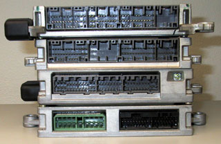

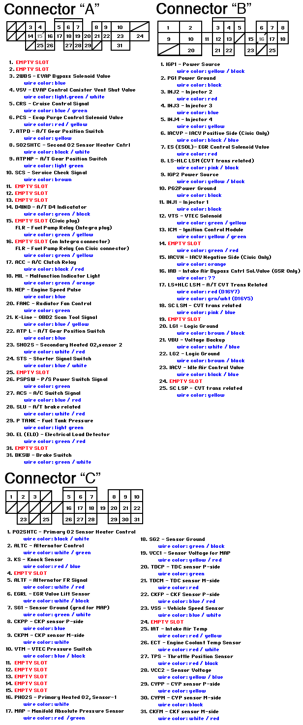

EK9 year 2000... ECU OBD2B...harness...
You are "missing" which connector? ... this is the ecu diagram pin out
TQ
addtional....
Reconfirm.... your ecu from top 1 or 2?
1. OBD2B
2. OBD2A
3. OBD1
4. OBD
