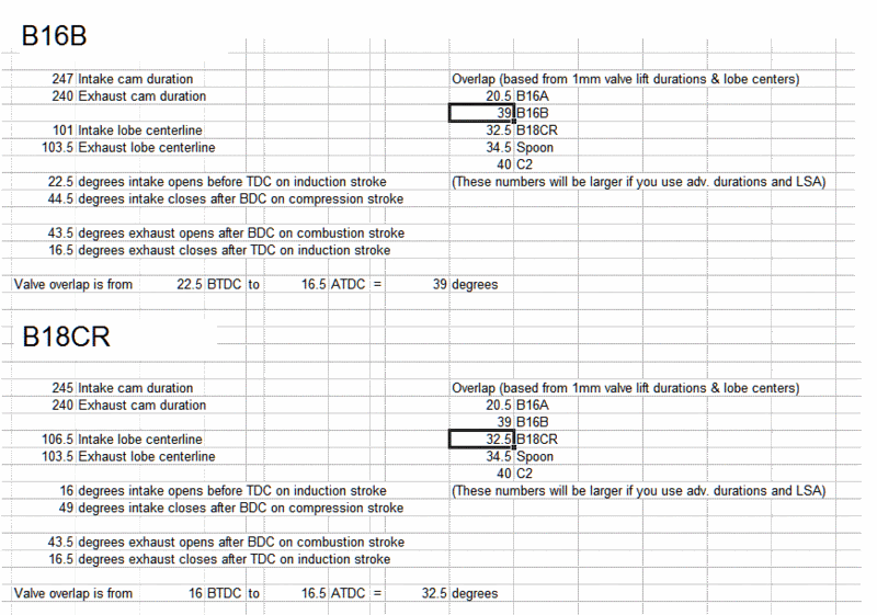

Well, here are the numbers I got from your picture, but do note that I have different numbers on file for B16B.. about 2 degs less.
But I think there will always be slight disparity as .5 mm wear on cam followers/cam lobes = near 1mm of valve lift loss, so I can accept that as a reason why the durations and the numbers on that paper and mine are different. Anyway, I've never measured a new cam with new rocker arms, so maybe that's why I'm getting numbers that are less than what's usually printed.
Also it could be due to different years of cams, like moshpit noted, as my B16A intake cams are giving me 10.44 valve lift instead of 10.34 as noted in your picture. But it could be the cam dial as well, since it only measures up to 10mm of lift, so I had to get creative and extend it, so that might have given me some errors as well.
Thanks to Seong from Bukit Kemuning for teaching me how to lock the midlobe in position to do this.
The valve overlap are always larger for high comp engines, so that's probably why you're seeing high overlap numbers for B16B and C2 cams, so maybe B16B do have higher compression than a B18CR. If someone has measured them before (when stock) please let me know.
The intake closing timing affects your dynamic CR, which is why some setups seem to run fine on normal fuel even with high compression.
If you think this is confusing, yeah.. I am too.. hahaha... (O_o)
Well, this is my ongoing research, so my opinions will change as I find out more. Before plonking 3K-4K for valvetrain, I'm gonna make sure what I need. I think that since I'm aiming for a street setup, those Mat Salleh stage2s should be good enough I think. Thinking of BC cams, but well, until I finish this and do some more research and saving up money, it's still a long way off.
Edit: Oh, just noted, it's 'exhaust opens after TDC on combustion stroke.' not stated in the screencap I did. The exhaust valve actually opens while the piston is moving down on the combustion stroke.
BTW, the intake centerline numbers are the suggested setting from the manufacturers so that you have ample valve to valve clearance. So your mech usually tweaks them for power by using those cam pulleys, and that's how they can manipulate the overlap.
Which is also one reason (I think) why two cars with the same similar setup may not get the same numbers on the same dyno.

from my observation, b16b have extra overlap on the intake due to earlier valve open angle before TDC.... does that play much part for its power?
besides, how if a person with b18cr to use b16b intake cam, will that make the b18cr generate more power??

Seems like for high compression engines, big duration primary/secondary lobes (not the VTEC) are needed to enable the engine to run higher ignition timing without knock at low/mid rpms.
Part throttle??.. Hmmm.. this one, I don't know yet.. I'm still on the stock intake manifold, so I'm logging all the stuff I can for the stock stuff, so when I swap, I have a baseline to compare to.
I haven't seen this new invention, but it does sound like a slide carb though. (O_o)
Studying cams, it seems like the big durations actually makes high rpm compression a lot less than the static. But I understand the big duration needed part, because at high rpms, the valves would close too fast for proper filling of the engine cyclinders.
So the idea seems to be like yours, that high compression makes power.. The question is how, which I'm still researching now.
about the throttle valve... you can have some reading here
BMW World - Technology
about the higher compression makes power, to me i guess it's because of the higher compression pressure, makes the combustion more powerful (ie higher pressure equal to bigger fire equals to higher push equals to piston move downward faster equal to extra enrgy produced)
make sense right??
besides higher compression, there is also need to ensure the intake could suck in more air and fuel.... job of the camshaft.
higher air pressure entering.... job of the intake manifold
better breathing through exhaust pulsing... job of the exhaust system
