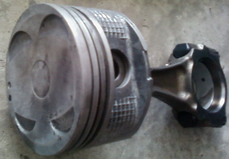

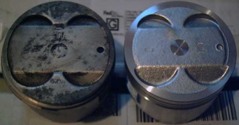

hi trd, sent my car for overhaul last week and change 4afe pistons to bluetop 4age 16v pistons...Im wondering if it's 'safe'. Hopefully no complications.

bernard, i think you're gonna dissapointed

Ermm.... why sifoo say so? Mind to share?
But Bluetop piston into 4AFE... It may increase only about 2% only... Because both ratio are about the same only.

im no sifu leh... as u said lor, its abt 2% gain only due to higher comp only. But he is looking for significant power gain so he is going to get dissapointed lo
