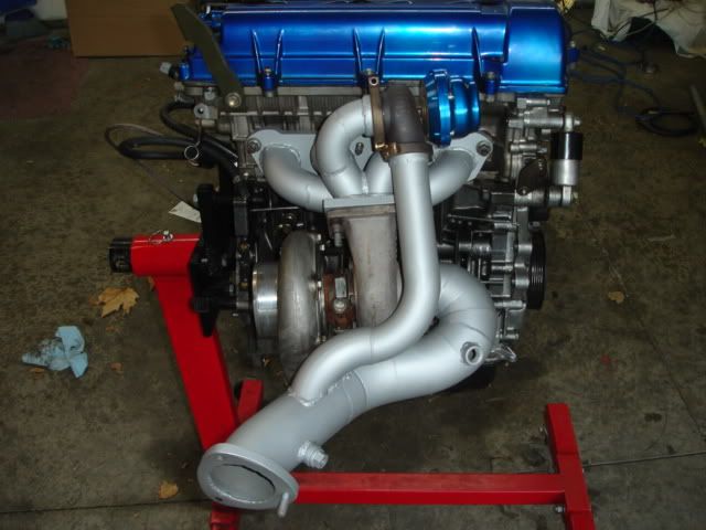

Bro ~ Why this wastepipe ..he didnt point the floor and he connect to the exhaust there..
Any idea?
Any idea?
Any idea?
for me leh,this kind of setup is ok for street use.it obstruct the exhaust gas flow on boost.
the higher the boost,the exhaust flow become restrictive and causes turbulence in the
exhaust pipe.just my 2 cent.
Yes brudder, we're talking abt street car now. My set up allows me to be loud or quiet. But I still like it to be quiet.
Btw, for street purpose ... We normally vent out the exhaust completely. Track purpose what's the use of the muffler..? It's also a restriction to ur exhaust...
And if u try it on a dyno, the difference is not too obvious. A few horses maybe...

Lolz.... so damn desperate meh..? Okay... There are other options...
As u've mentioned, u're using an RVR engine. So, I assume u're using a TD04L. Well, even if U're using a TD05. It doesn't matter.
If ur investment are purely for the NOISE... Opss... I mean sound... Then U can just call JIAN HANG to direct the waste pipe out from the exhaust instead of venting in...
However, if u really know how much the an external wastegate worth installing, what u can do is.. throw the original waste dish.. Port it to 38mm. Then, at o2 housing, direct the hole to the external wastegate. And from the wastegate, point it down to the floor.
That's the actual way of installing an external wastegate onto a MHI turbo on a stock manifold.
Or else, to look gaya, just plunk in banana.

Tial wastegate = 800-850
To remove the flap + port the turbine housing = 180-250
New exhaust O2 housing + piping modification =300-400
that's the rough costing of the $$$ u gonna spend.
Or u go for the cheap way. Cut the hole on ur manifold. Weld a pipe on the manifold to the wastegate, then close the flap on the turbine housing and weld the actuation lever. And there u go.
But if the tahi welding drop into ur exhaust manifold, there goes ur turbine fins. Unless the installer very detail n knock out all the shit completely. Then, it's ok.

That's for MHI turbo lag dude. U already using T25. The turbo inlet flange same as t28 wad what's the problem?? If u are already using a stainless steel exhaust manifold, just add on an external 1 1/2 inch schedule 10 stainless steel pipi at the place where the 4 runners joins together. And weld the internal wastegate lever of ur turbo. Apa Susah???
