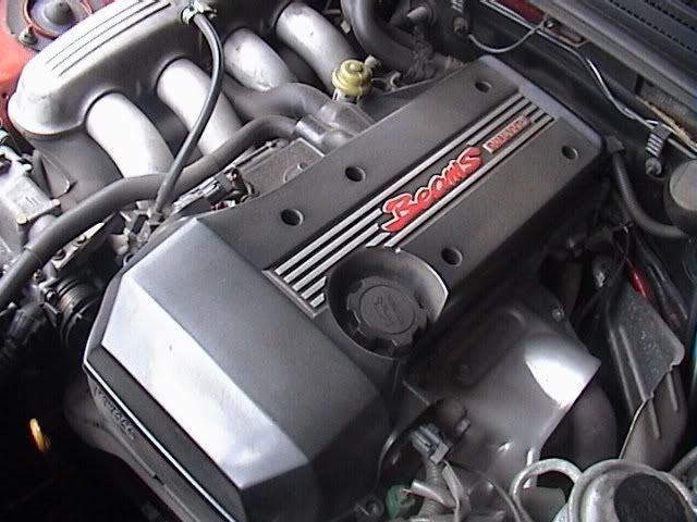

As both the RS200 and the AS200 share the same chasis, u need to pop the hood and look at the engine ... The most obvious difference will be that the RS runs on a 3sge 4cylinder Beams (Yamaha-Toyota collab.)engine whereas the AS runs on a 1gfe 6cylinder engine..
The engine cover on the RS200 has got the words "Yamaha"/"Beams"/"3s-ge" engraved on it..

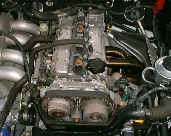

Beams dual vvti engine - RS200 model
Timing belt - engine

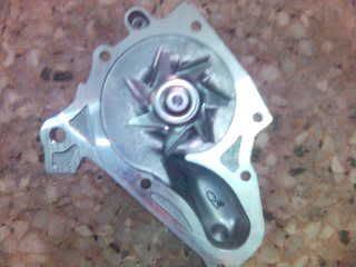

Water pump

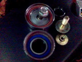

Bearings
