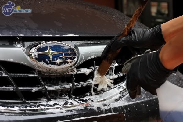

Bodywork is washed with Chemical Guys Citrus Wash and Gloss and a splash of Osren Degreaser FX for extra cleaning power. Paintwork is then smoothened with Osren Magic Clay Cloth. Old duck tape residue removed with M6000 Wax and Grease Remover.

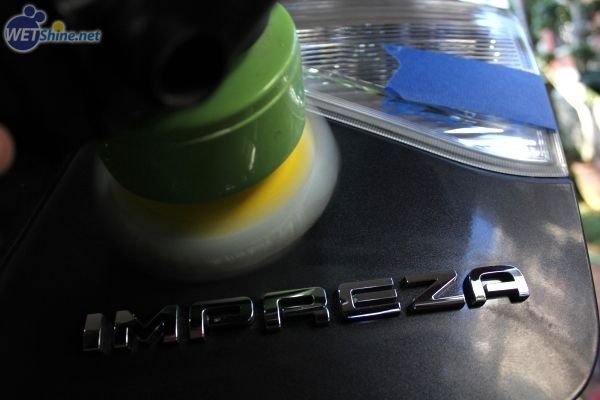

Process for paintwork preparation and orange peel reduction.
1. Osren P40 Compound, Osren Velvet Pad, Rotary @ 900 RPM
2. Meguiar's #105 Ultra Cut Compound, Lake Country White Polishing Pad, Rotary @ 1200-1500 RPM
3. Meguiar's #205 Ultra Finishing Polish, Lake Country White Polishing Pad, Dual Action @ Speed 6
4. Dodo Juice Lime Prime, Lake Country Black Finishing Pad, Dual Action @ Speed 5 -> 3

The rear plates were removed, tail gates and both bumpers were prepped using:
1. M105, 4" Surbuf pad, DA @ Speed 5
2. M105, 4" Lake Country Orange CCS, DA @ Speed 5
3. M205, 4" Lake Country White CCS, DA @ Speed 5
