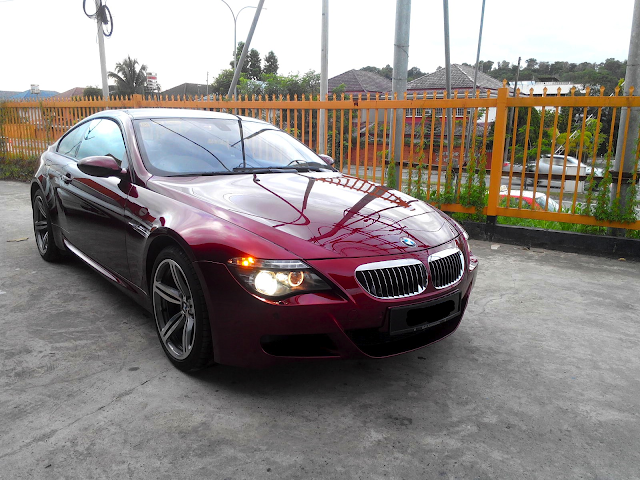

The car was first given a thorough wash. No water beading was found indicating the lack of any protection.
Water wetted the whole surface with some tar spots found on the bonnet.

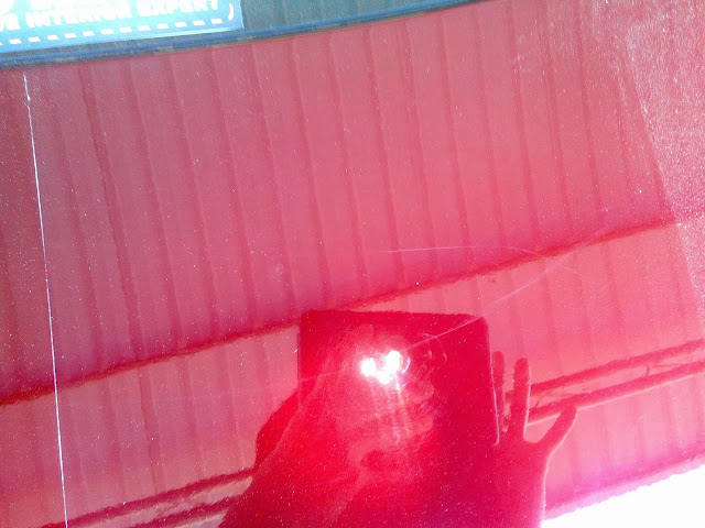

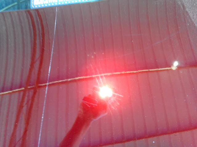

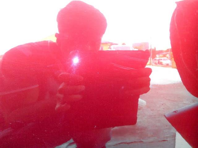

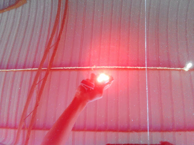

Further inspection under the sun and LED lighting revealed generous amounts of swirls throughout with several random deep scratches
Swirls and random deep scratch on rear boot
Swirls and deep scratch on rear bumper.

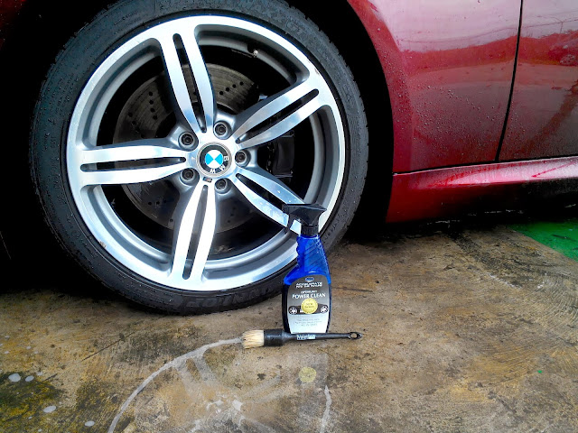

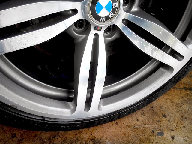

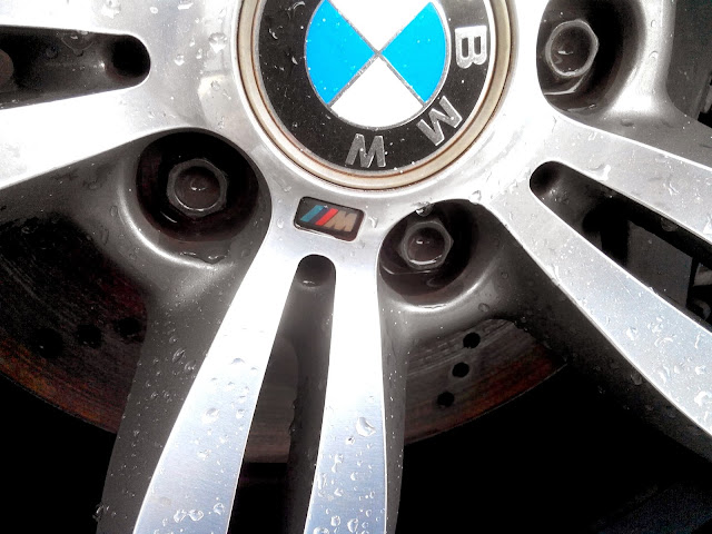

Before - These places where people neglect and pay less attention to. Years of dirt caked into the lug nuts.
After
Before
After
30 minutes on each wheel. A total of 2 and a half hours for wheels and tyres alone. Cleaned with Osren Multi Clean. Sorry I just used another OPC's spray bottle to dispense

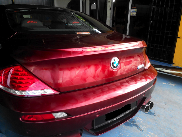

Rear bumper before - white tape in place as reference point.
Rear bumper after.

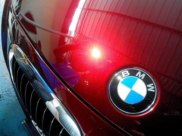

The whole car was given a 3 step paint correction over 72 hours.
- Osren 34 on wool pad
- Osren 34 on Polishing pad
- Finished with Osren Perfect Finish 8 on polishing pad.

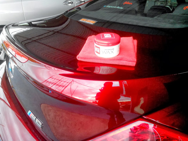

Paintwork LSP is Autoglym High Definition Wax
Wheels were cleaned with Osren Multi Clean and coated with Opti Coat Pro.

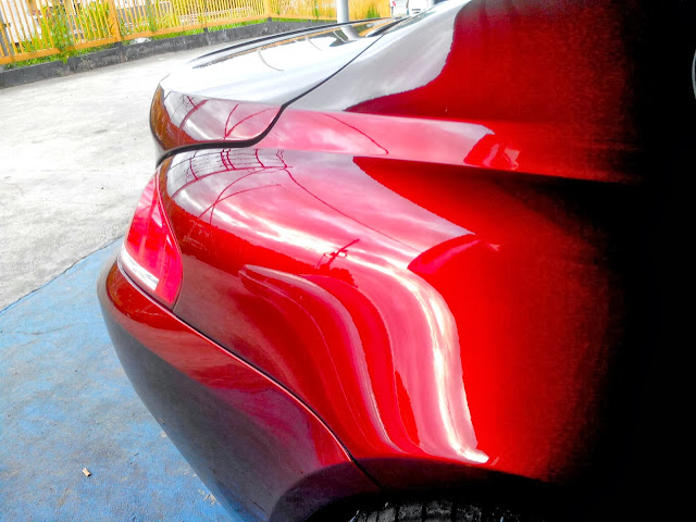

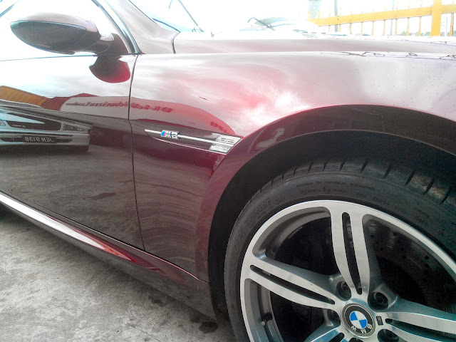

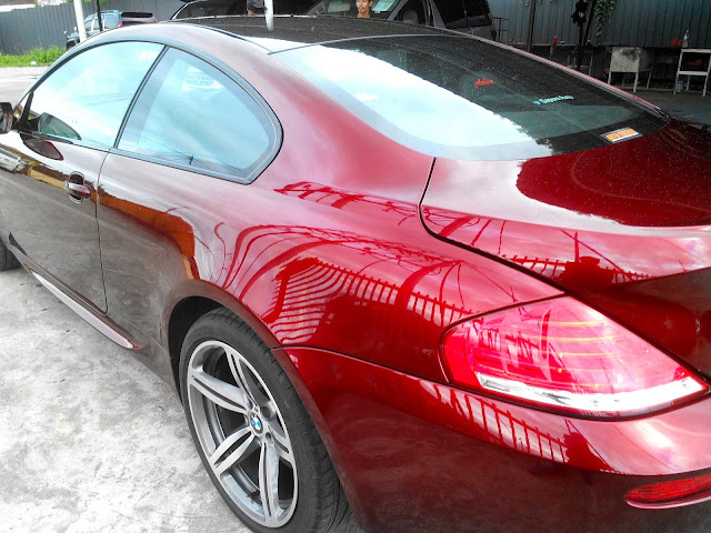

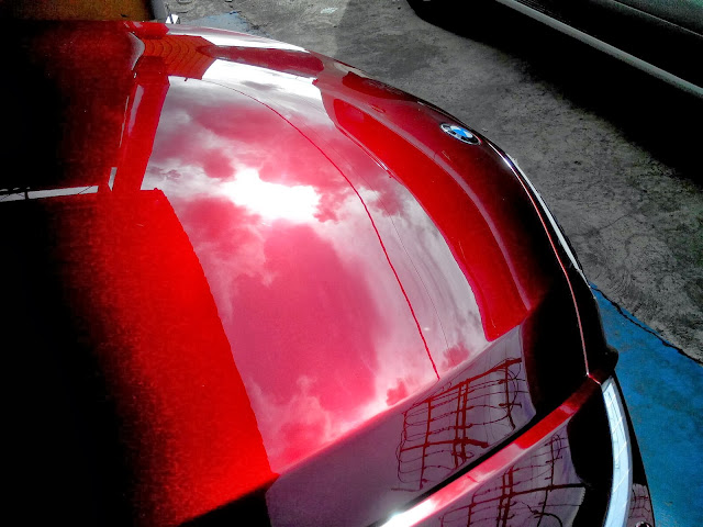

Some post detail eye candy. Enjoy the high definition reflection and gloss...
After
Before
After
