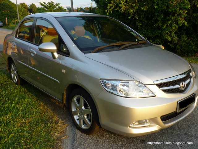

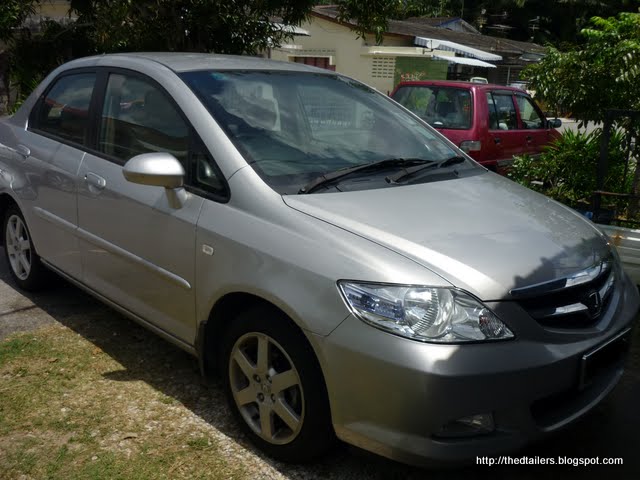

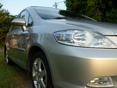

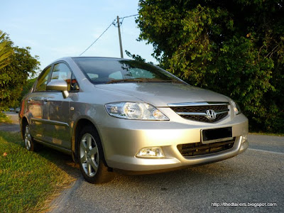

Just Barely 2 years old - visible swirls hardly found...except close inspection under sunlight...a very good colour for hidding swirls

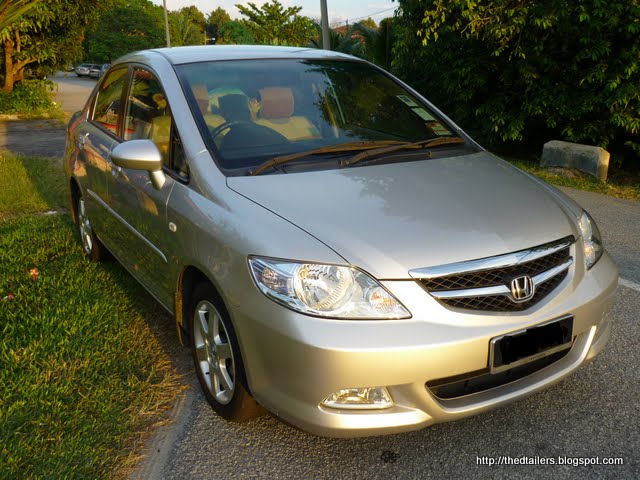

Mission - to restores her to show room condition.
..this was my 1st detail over chinese new yr break

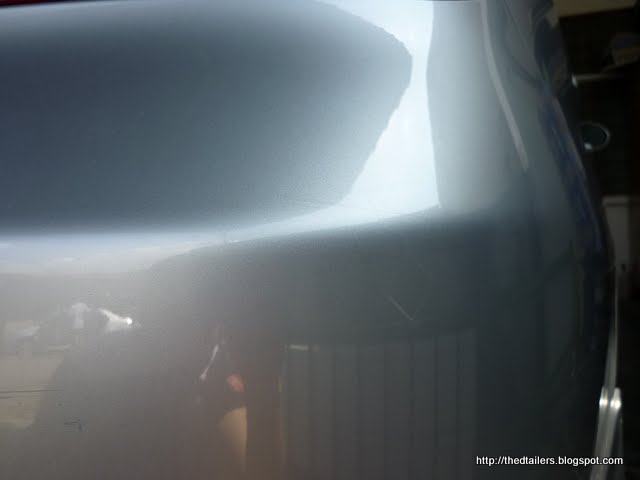

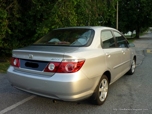

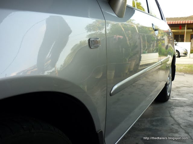

under sun...not too bad looking

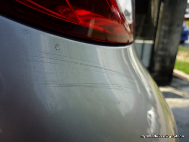

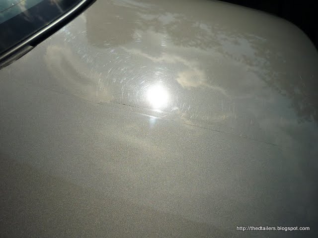

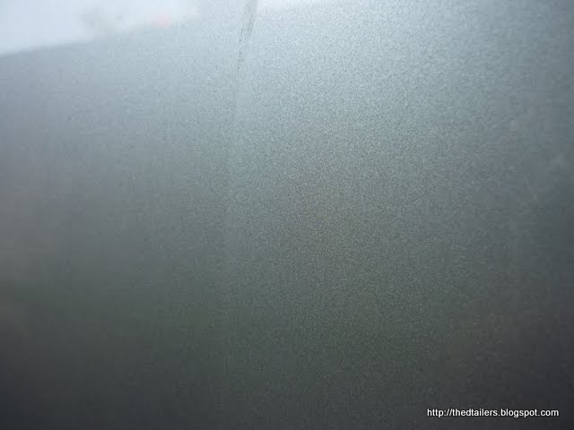

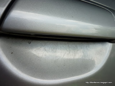

just got it on CNY - 2 yaers old car - lady driver - fequently wash by road side car wash & resulting....swirls & deep scratches

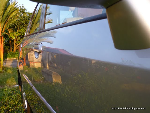

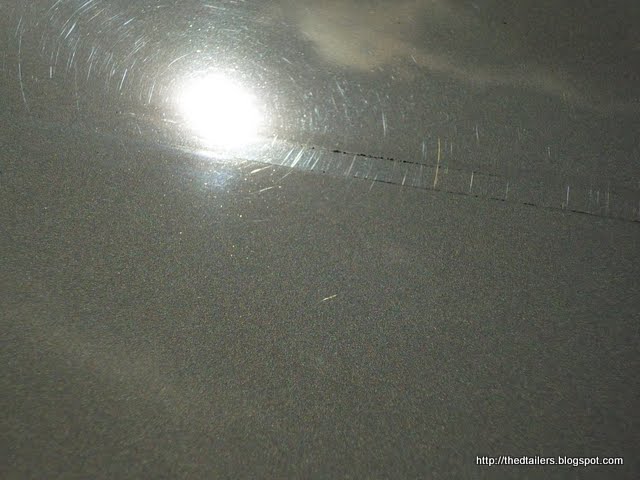

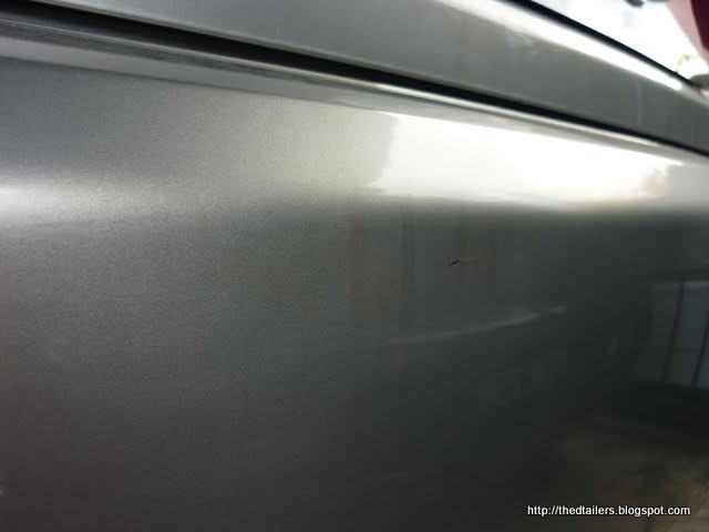

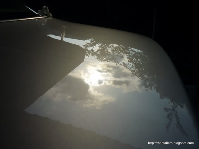

this is one of the rarest moments - finding swirls under bright sun light

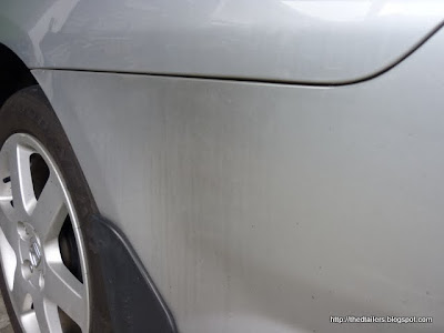

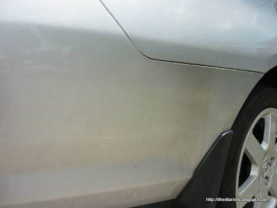

stubborn stains

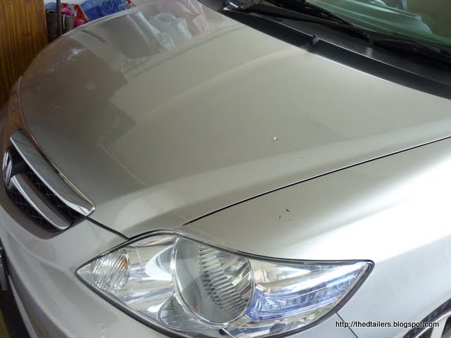

looking good from a glance

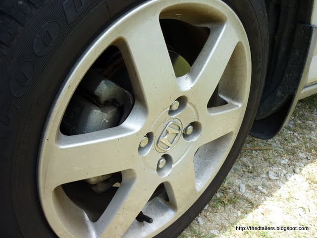

wheels before

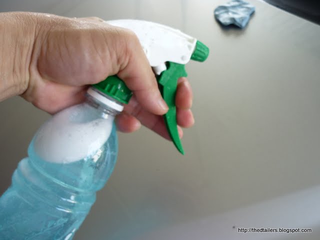

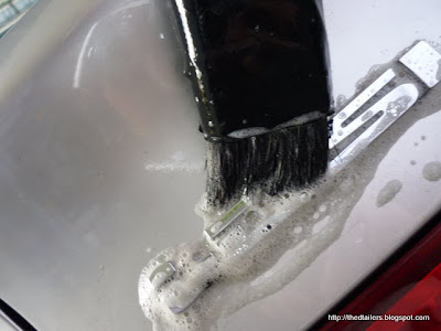

2 bucket wash with APC 2oz mixture - micro fibers

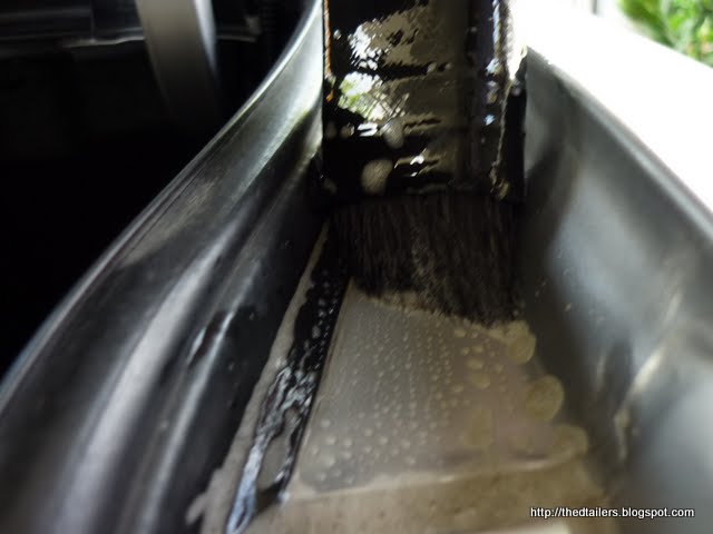

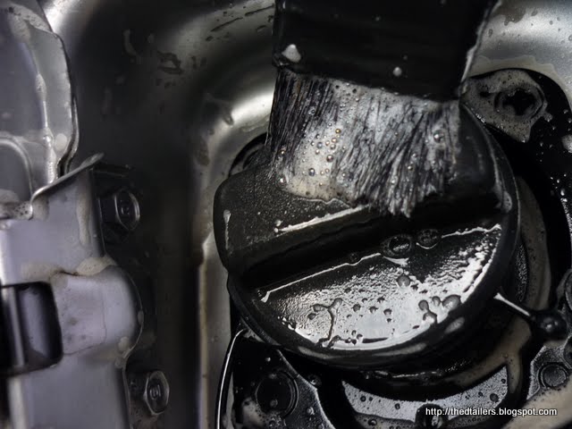

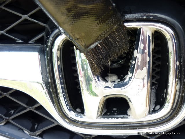

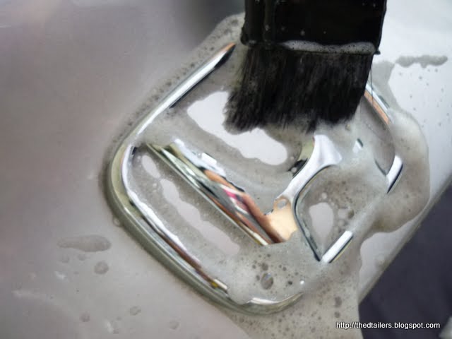

Osren Multi purpose cleaner with assorted brushes to cleans emblem & hard stained area

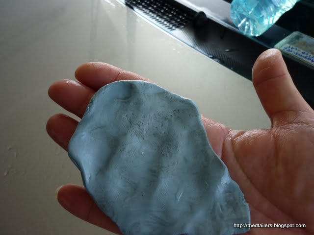

Optimun no rinse was as Lube with mild clay

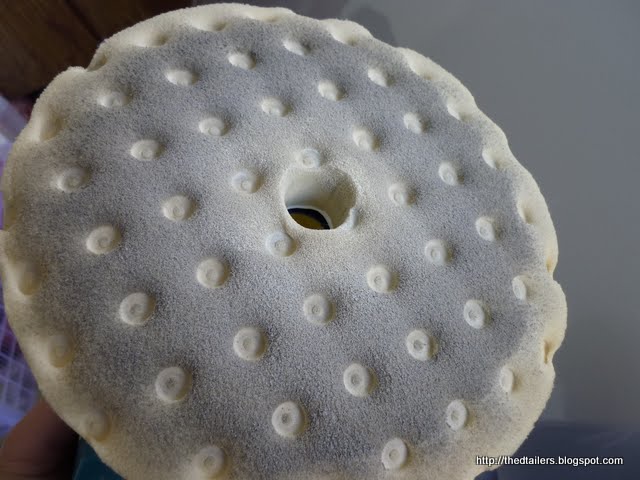

Paint correction - Rotary with Lake country Yellow colour cutting foam for removing swirls & Random Deep isolated scratches (RIDs) with Meguiars M 80 Mirror glaze polish ....speed 600 to spread, 1000 with gradual movement & speed , finishing off at 1400 with moderate movement
paint polishing - rotary & Lake country polishing foam pad at speed 600 to spread the products & Speed 1000 move moderately with pressure & backing off to speed 600 with light feathering off

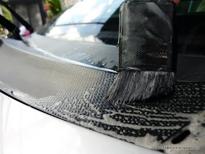

Osren MPC at work
mkore MPC at work agitating

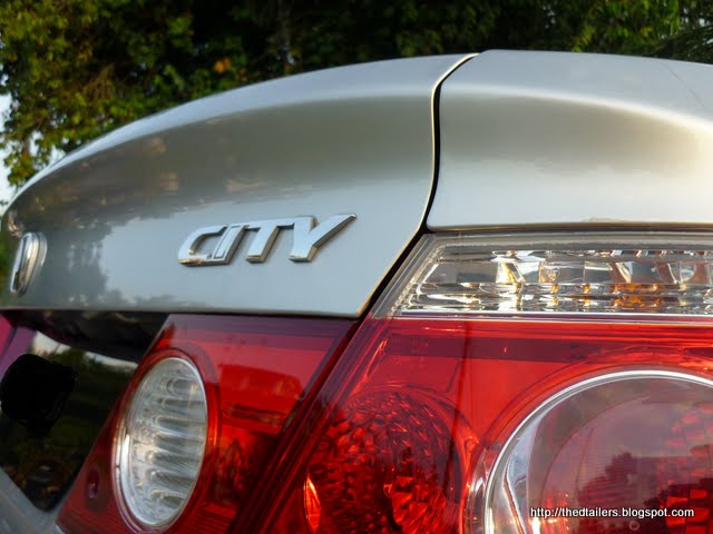

front bonnet plastic fender
front emblem cleaning

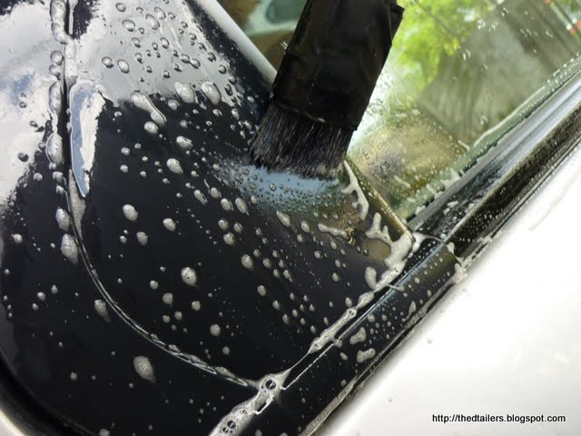

d window frame plastic stained cover agtating with MPC

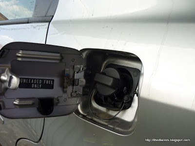

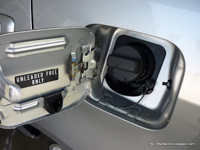

before fuel cap area
agitating
tatatata - show room condition possible

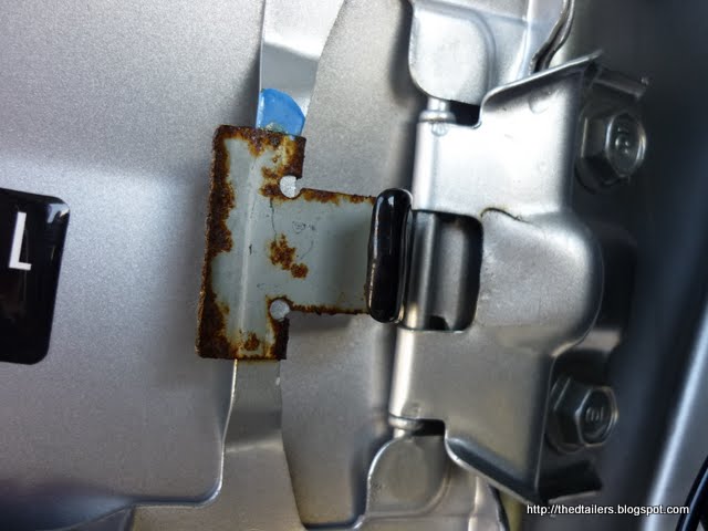

this is what i discover - warning - this rust gonna
claying - prior before paint correction to pick up - upper paint contaiminants - like brake dust, industry fall out & tar
optimum no rinse wash diluton 2 oz per 450 ml of water as lube
clayed pick up

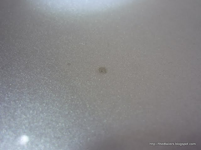

now after a clean wash...closer inspection on lower paint contaiminations
lots of stains - hardly can be removed by mere washing & scrubing

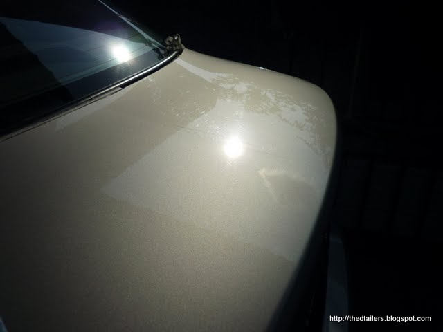

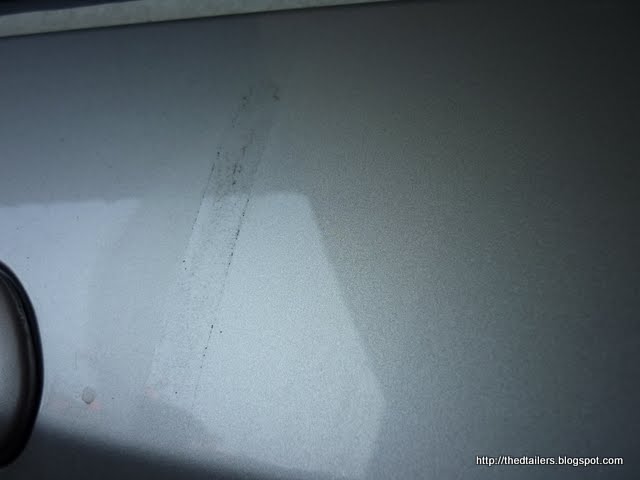

i tape to shoot this comparrison area (left before & right after)
clearer 50/50 area
close up picture comparrision on

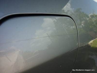

paint correction began - fuel cap area
before
more before - rear left bumper
after
only after one pass

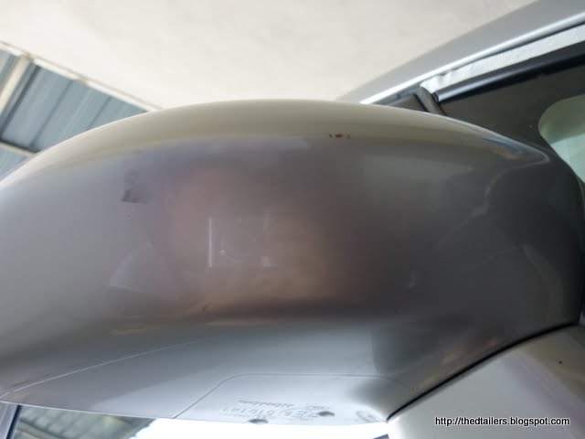

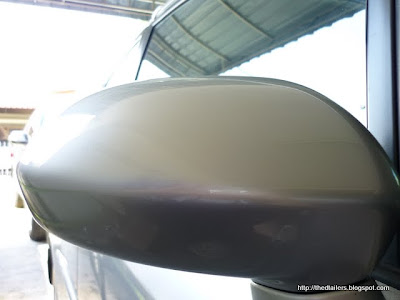

side mirror before
after detail

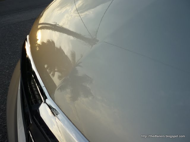

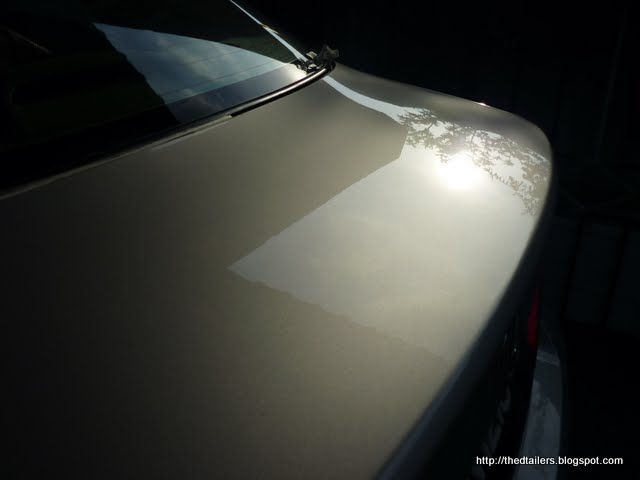

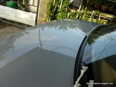

after rear bonnet corrected
some sun light shot at the rear
side view

now the rear look

side gloss restores & depth is visible

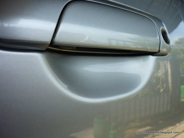

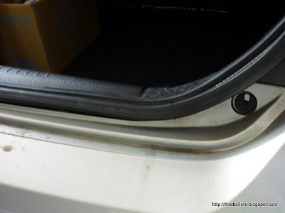

door jam area -
before
after
only after one pass
side mirror before
after detail
