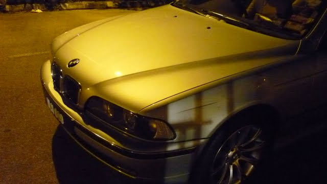

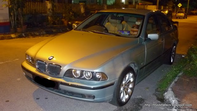

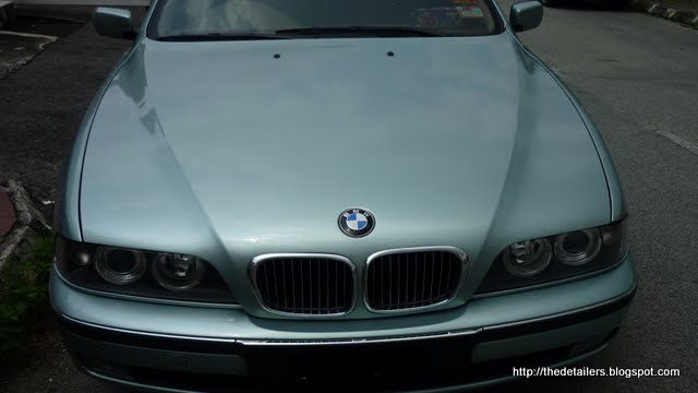

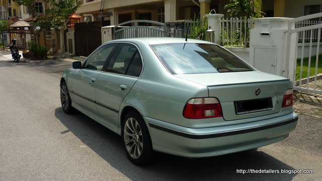

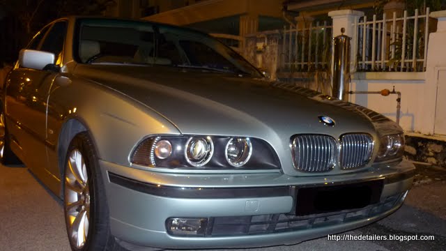

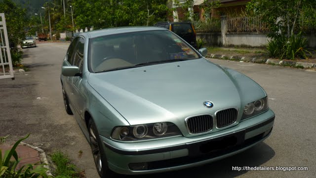

My friend partner, was pretty unhappy with his current paint condition.....as his 2nd hand E39 was not in a great shape...as planning to splash $$$$$ to repaint
frankly speaking silver from this distance look great
a prefecft colour to hide all paint imperfections
but to a true UDM lover......you just want it
before
to this

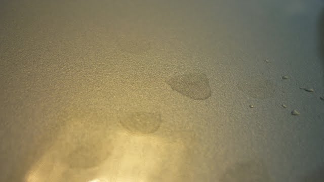

as he has not come across a single detailing product can rectify this defect......swirls, scratches..

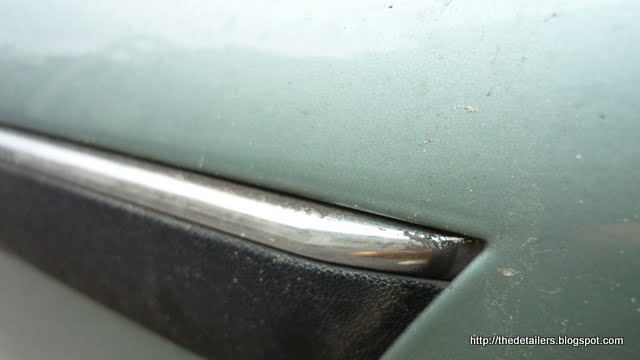

13 years old stain on the steel trims
now u see

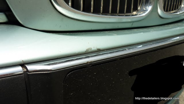

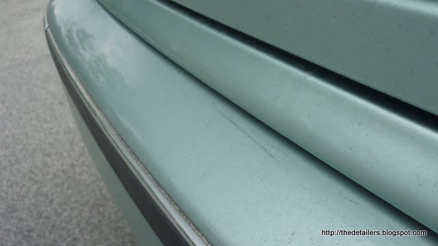

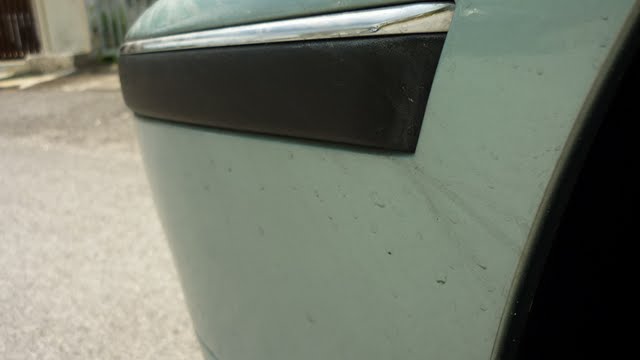

scratches on the front bumper
we had the opportunity to meet last sun & got it full corrected

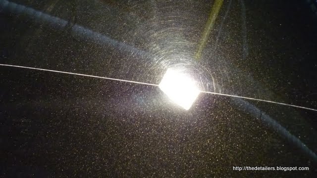

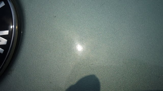

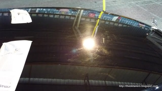

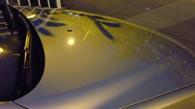

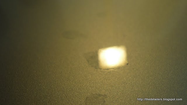

ver visible swirls on the hood

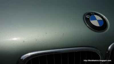

lots of stone chip & different tone of touch up paint
from this

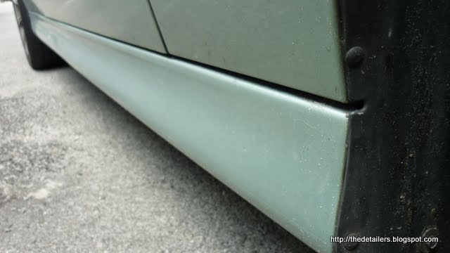

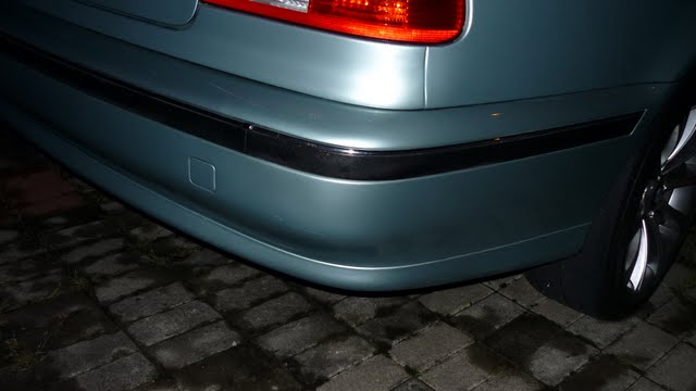

left rear bumper scratched
right rear bumper scratched

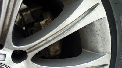

hard to keep the wheel cleans too....stains

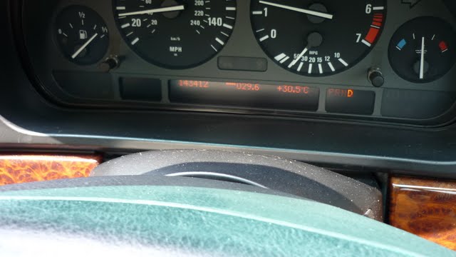

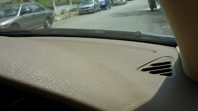

dull & dirty dash board
look at the unattractive dash board

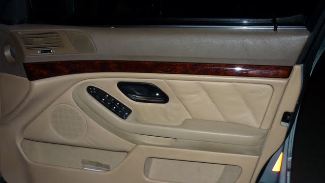

door panel stains
more stains

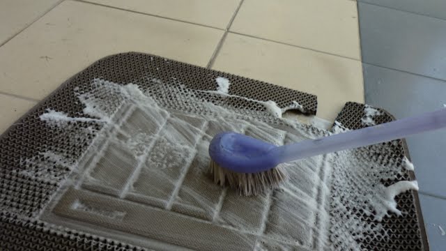

later was clean by Osren Multi purpose cleaner ....1:10 water dilutions
spray on soft hair bristle brush prior gently scrubbing it

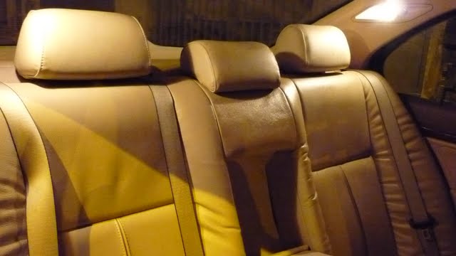

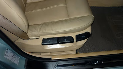

shoe stains on the seats
carpet brushing

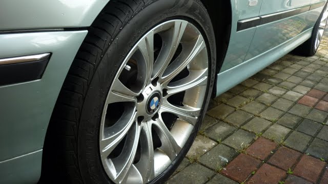

ta da a clean wheels
osren Multi purpose cleaners 10:1 with soft wheel brushes

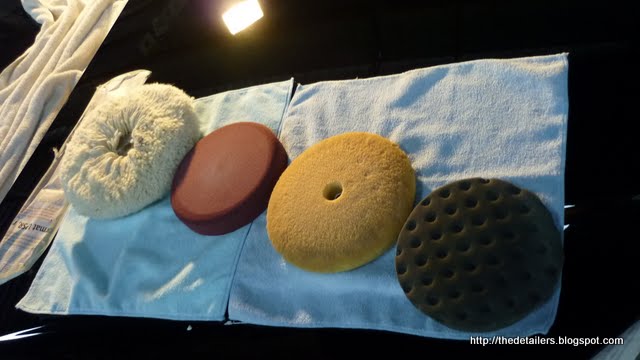

my choice of pad

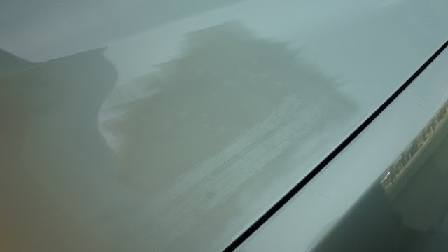

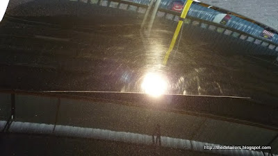

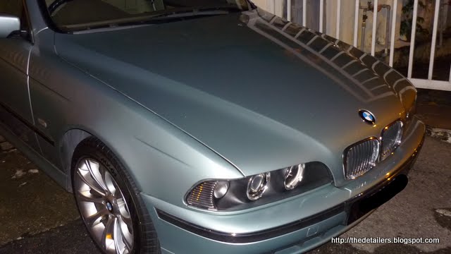

For body corrections, swirls & rids...i used Makita rotary wool pad wioth Meguiars M#105 speed 1 to spread & speed 3 to correct
Then step down to Makita rotary with Meguiars Cutting pad with Meguiars M#105 speed 1 to spread & speed 3 to polish
Polish with Makita rotary meguiars polishing pad with Meguiars M#205 speed 1 to spread & speed 2 to polish & speed 1 to finish
Then Meguiars NXT sealant wax...

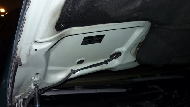

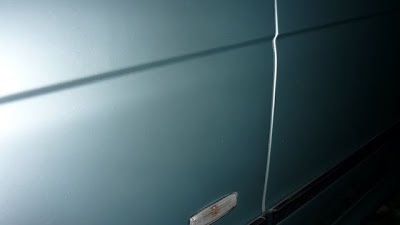

clear coat corroded by acid splashes
another acid damage on the clear coat paint
wet sanded
2000 unigrit sand paper

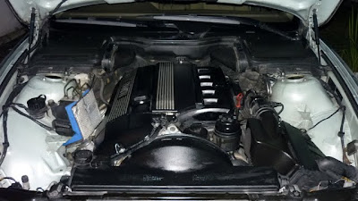

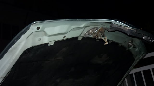

all engine interior clean by Osren MPC & With soft hair brush
clean engine hood
area most avoided
engine dress by Meguiars gold class

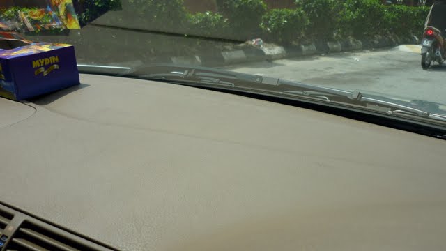

now the restored & detail interior
look at the dash

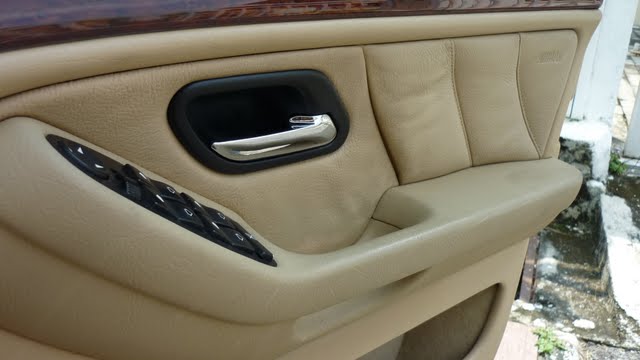

side door
remember the door panel stains before
conditin by Meguiars gold class leather conditioner ALOE
this is a pure condtitioning cream
remember before
now
now after detail
now
remember before
ta da
remember
now

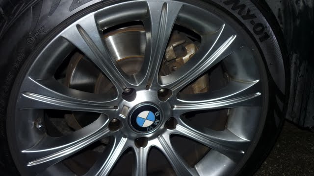

wheel before
now clean by osren MPC, Wax & seal by Meguiars NXT

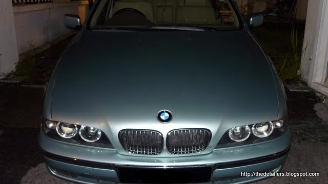

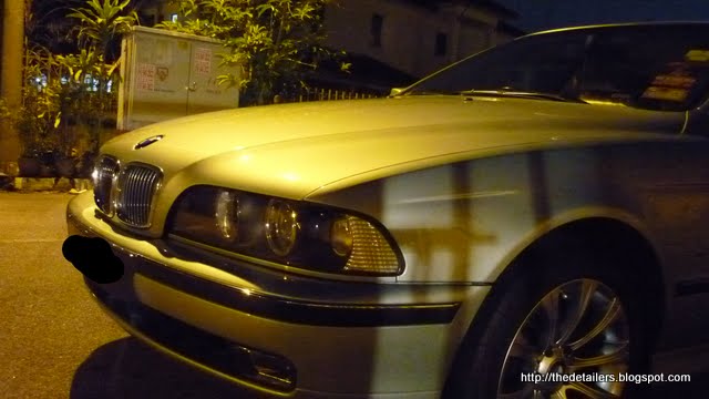

after pics
ta da
i am happy to save another ride from paint shop & did some good thing to the envioroment
Thank God it turn out well
proud looking RIDE now
